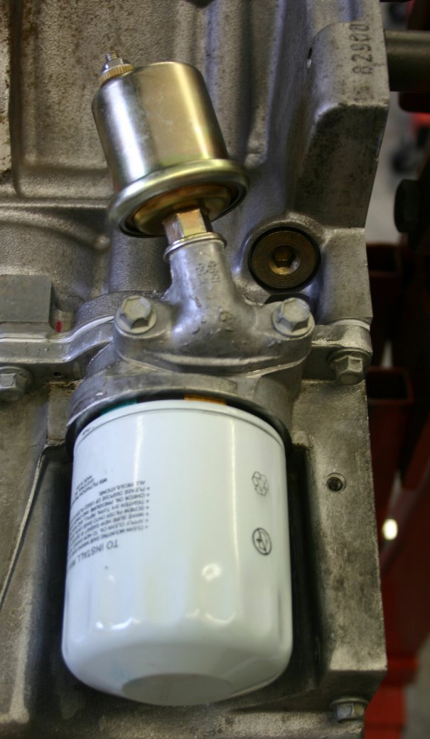

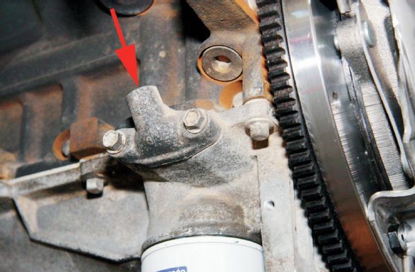

The conversion is very straight forward, my truck is an 87 V10 and I bought coolant and oil pressure sending units for that year pickup. Think I gave roughly $25 for the senders, some shrink tubing, and a tube of automotive grade thread sealant.
Oil Pressure-
Remove the coolant bypass block on the LS. It is next to the oil filter and has two 10mm bolts and an o-ring type gasket that can be reused.
Then drill and tap the boss on the block. My oil sender was 1/8" NPT. Use thread sealant on the threads and reinstall the coolant block. Find the wire for the oil sender at the firewall bulkhead connector and connect it to the oil sender.

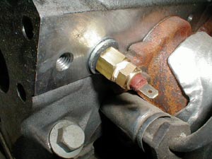

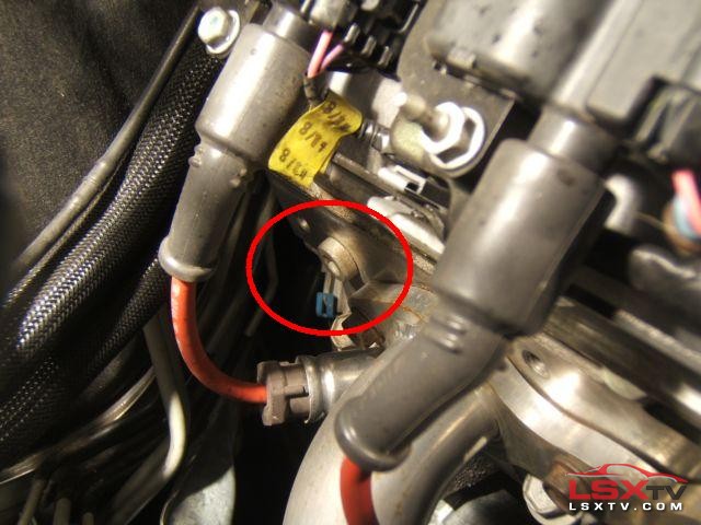

Coolant Temp-
Find the coolant port plug on the back side of the passenger side cylinder head.
You will need to make or buy an adapter to to mate the M12x1.5 threads in the head to whatever your coolant temp sender threads are, mine were 3/8 NPT.
I made my adapter however, you could simply drill and tap the head for 3/8 NPT. once you have your adapter use thread sealant again and install the sender into the port. Again, find your coolant temp gauge lead on the bulkhead connector and route it to the new sender.

And you're getting an electrical connection through the thread sealer? That's great! What sealer are you using?
