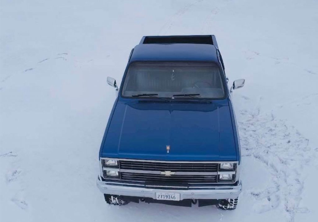

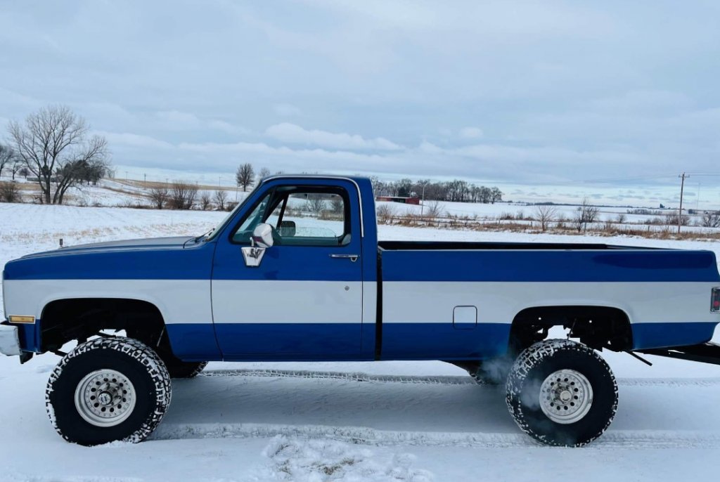

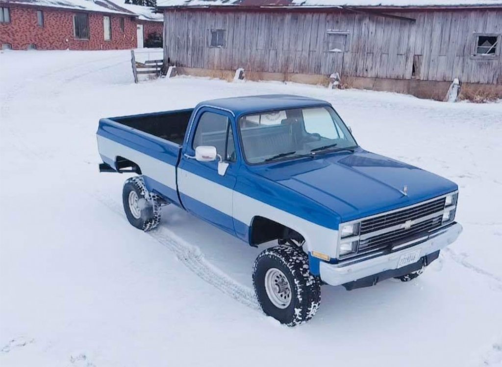

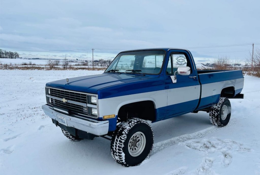

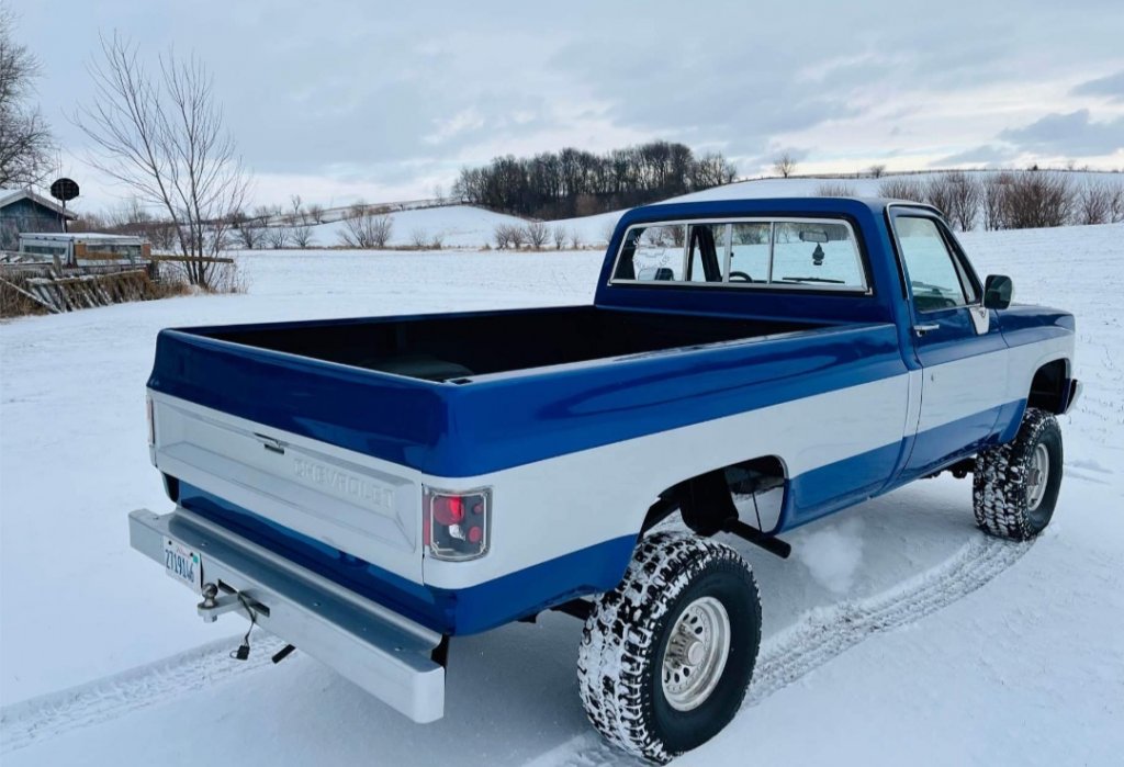

Here are some pics from delivery day!!

OMG. Don’t touch it! Awesome lookin truck!
1. Maybe. We had an old K20 on 33s at work, back in the day. Best of my knowledge it wasn’t lifted. Guarantee they won’t fit with anymore than a 0 offset though. Without taking the die grinder to your shiny fenders.
2. Absolutely there’s a market. Especially if you know what kind they are.
If they were soft rides and I lived at our place in WI I’d buy em from you.
3. You didn’t ask this question, but if you’re gonna drive that in the winter hopefully the underside is as shiny as the topside. And whether it is or not, I’d shoot all the nooks and crannies with paint/rust reformer first and I’d coat the undercarriage and especially the inside of the body panels. Krown, fluid film, something. As quick as newer vehicles rust out up there, a square will rust out about twice as quick.

It was a frame off rebuild, blasted and and epoxy sprayed frame , all new steel inner and outer, original box bed and cab, new doors , hood and tailgait. i do have a case of woolwax waiting to be applied when weather gets better. it wont fit in my shop so it has to come down from the 81" stance it has now. it will be back to stock asap
