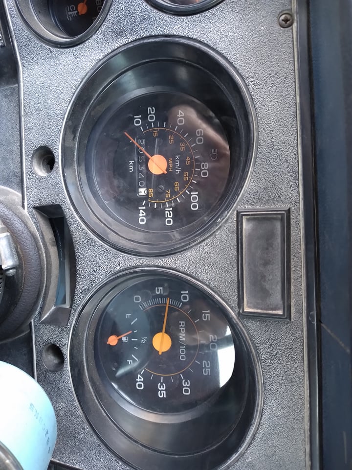

thx for the info just got a C60 diesel tach that i want to retro fit in my OEM C10 cluster! ;)
