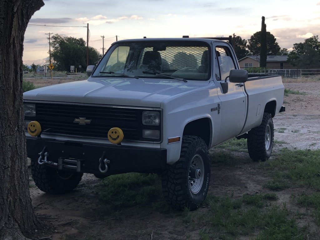

I towed my 28’ bumper pull this past elk hunt through some mighty steep mountains.Healthy 383,4 speed manual,4.10 gears.
That’s a experience.I’m doing it again and again.However,had it not been for the SM465,not really sure if I could of done it,not with no small block.440 foot pounds from 2500 through 4000rpm.
On the flat I kept up with all the new diesels.70-75 all day long.

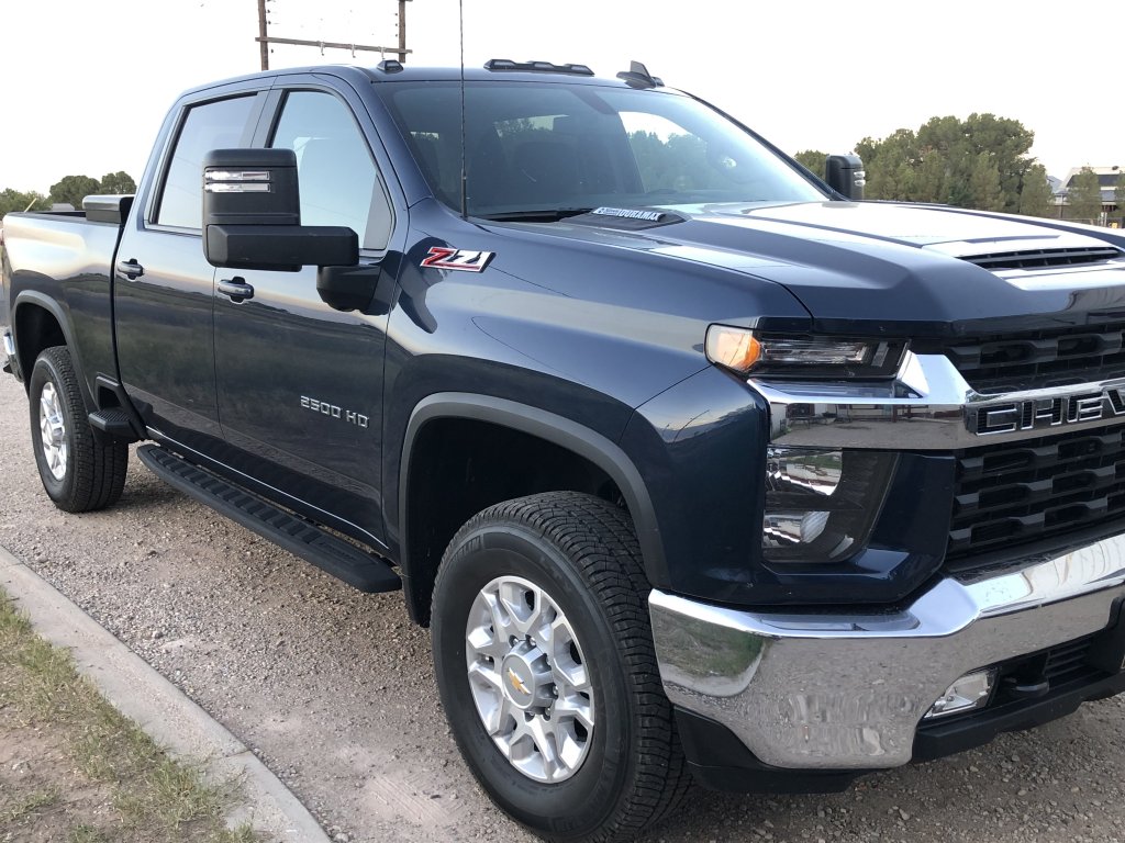

I would definitely go big block and fuel injection.That’s what I want,but we’ll see.If money was no object,I’d absolutely go Duramax.I have a 2023 with a 10 speed Allison that does 20mpg easy(I was and am still amazed).910 foot pounds.
My (sold) 2012 6.7 Cummins did 12-14 on hwy,stock engine,unloaded.
After you’ve towed with a newer diesel,towing is different with a old truck.I still enjoy the experience even if it’s a little nerve wracking.Nothing gives assurance like a exhaust brake tow mode
