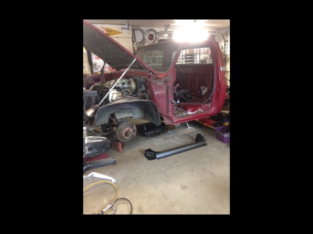

If you bought the full rocker you will need the fender off to install it. But check and measure check and measure again before the old comes off (if it’s not too late) so you will know your placement to get your lower door gap right.
