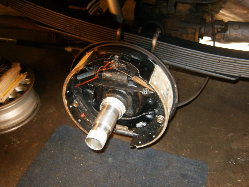

2X what J Knight says. But any improperly assembled parts might cause this issue. Here are some images to compare your brakes with:
In case you are concerned that the above images don't apply to your truck, here is my right rear brake fully assembled (1986 K30). It is the same:

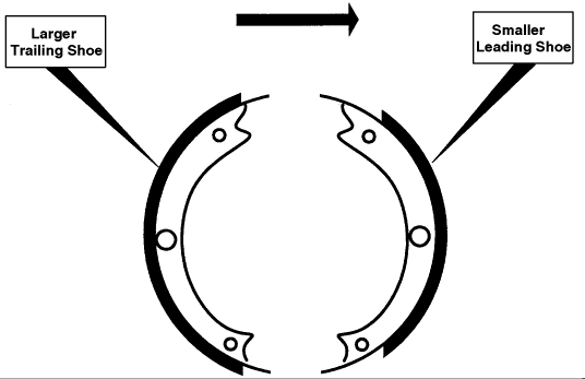

Look closely, the lining material extends higher up on the rear (trailing) shoe. And trust me - it makes a difference:

Can I reuse the shoes if I go ahead and switch them all around?
Yes - they should be fine. The front lining is lower so that the rear catches first when the pistons move out. It somehow prevents the brakes from grabbing ID of the drum and opening everything up.

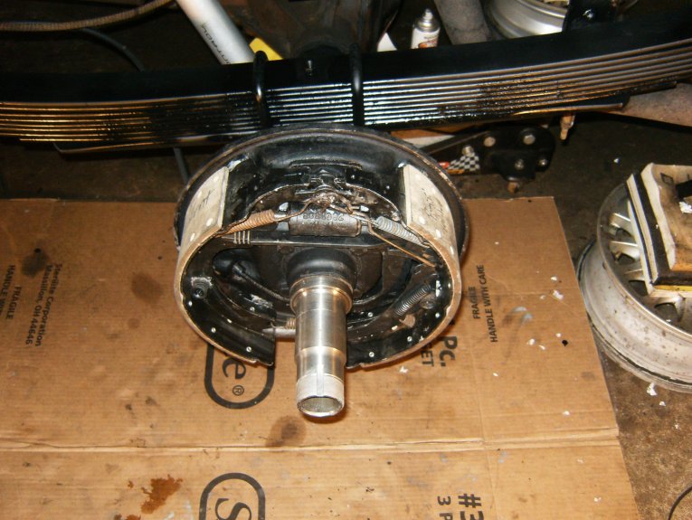

Here are some pics of the current setup. Please take a look and see if anything looks wrong.
Driver's side:
Passenger Side
Low and behold... I had put the driver's side drum together backwards. The short shoe is in the back...
Other than that - no, I can't see anything wrong. But that's just me.
I can't see any reason why you can't just switch them front to back and keep right on using them.
