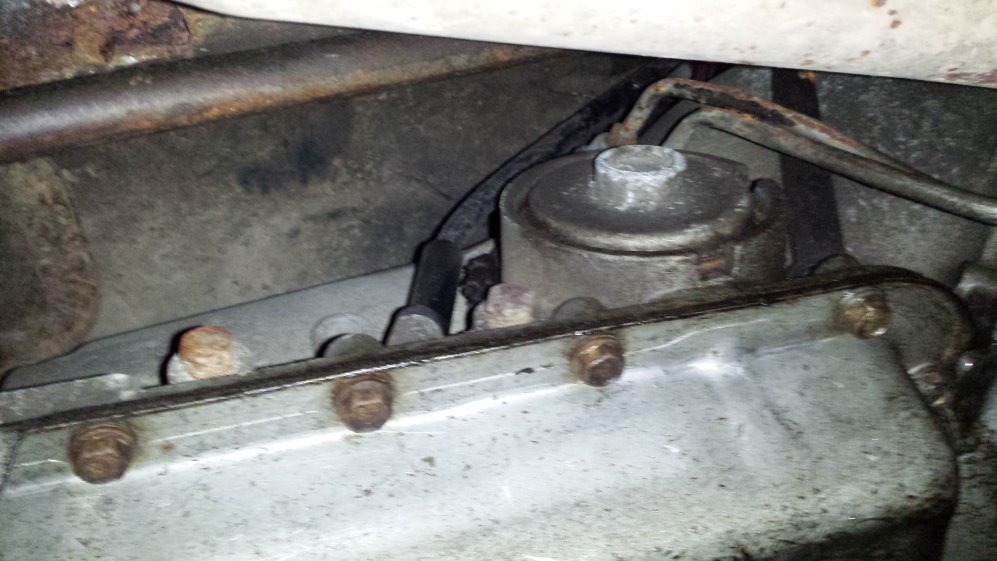

Well I just got underneath my truck, and I don't see a modulator? That's the passenger side view. I'm kinda confused..
47,045
9,087
Total different ball game now. That's a 700r4. 4 speed overdrive. Not a Th400. First thing to check is that the TV cable is not stuck out leaving the TV valve activated. This is critical on the 700r4.
