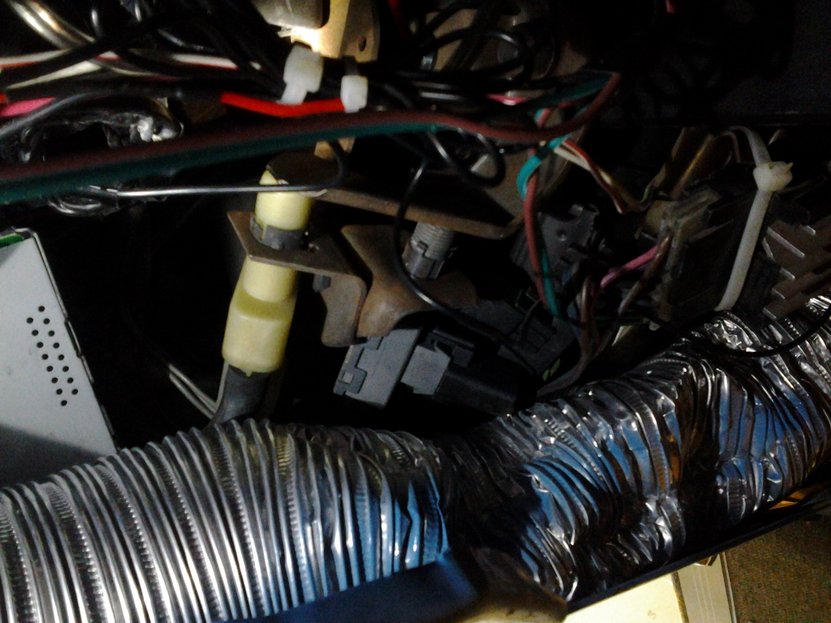

I don't believe so...the brake light switch (both of them) are plastic and have a threaded neck which attaches to the metal bracket behind the brake pedal through a barbed sleeve. There are seperate switches , one for each tail light. The only difference between the two is that the drivers side has a vacuum line on it which deactivates the cruise control when the pedal is pressed. Each switch has a pigtail that connects to each brake light as far as I can determine.
When I i stalled the new switch I also made sure to adjust the length in order for the plunger to extend out when the pedal was pressed (it protrudes out identical to the passenger side switch)
What are the odds that a brand new switch intermittently fails?
