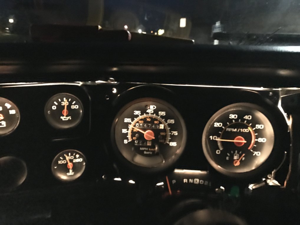

Was reading the thread on the best LED bulbs and seen superbrightled site. They have good prices but I got a dumb question. If I install their 1157 led bulbs in the front and rear parking lights, and their 194's in my markers front and rear, will I just need the flasher they sell? Or do I need to put their load resisters in each light for the parking lights to work? I was thinking of dash light bulbs also in clear. I'm going to do the relay headlight upgrade and I'd like to improve all the lighting while I'm at it.
