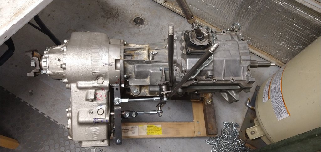

You need to verify what gears are in the rear. There's a thing called "Carrier Break" and I think it's between 4:10 and 4:56. You cannot change ratios higher or lower without changing the gear carrier. I put the , original axle in with the 4:10 gears recently while I removed the locker in the 4:56 axle. I definitely prefer the 4:56 over the 4:10 with the OD. Unless you have the hard to find and expensive late version (6 bolt round pattern) 205 case you will need an adapter for the nv4500 to 205 case. Your 465 should bolt up if the splines on the input shaft are the same. If not, a new shaft is inexpensive.
That’s a nice setup but too many variables for me, having no experience with this swap, I’d rather do the GV since there is less chance of me buying all the wrong parts,
I appreciate all of your information
