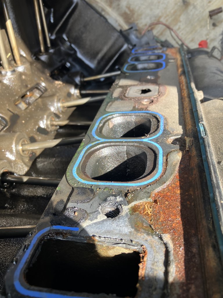

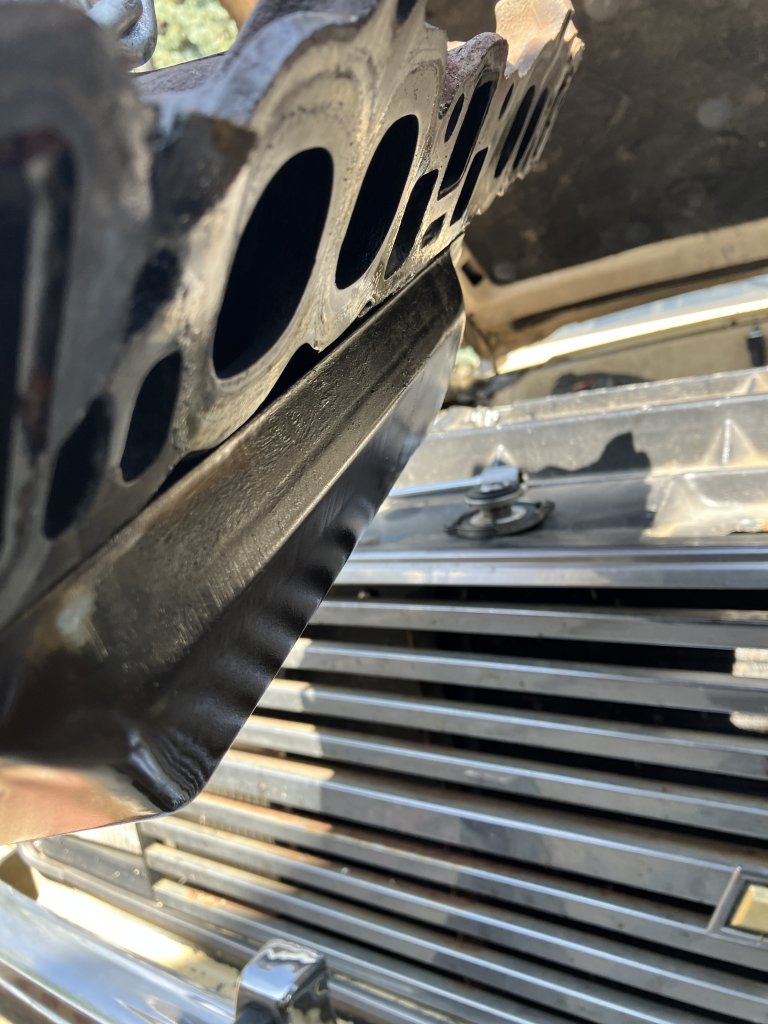

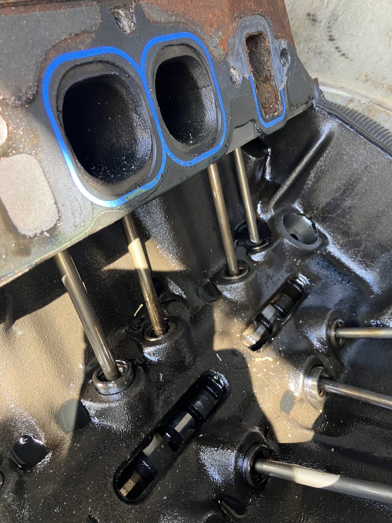

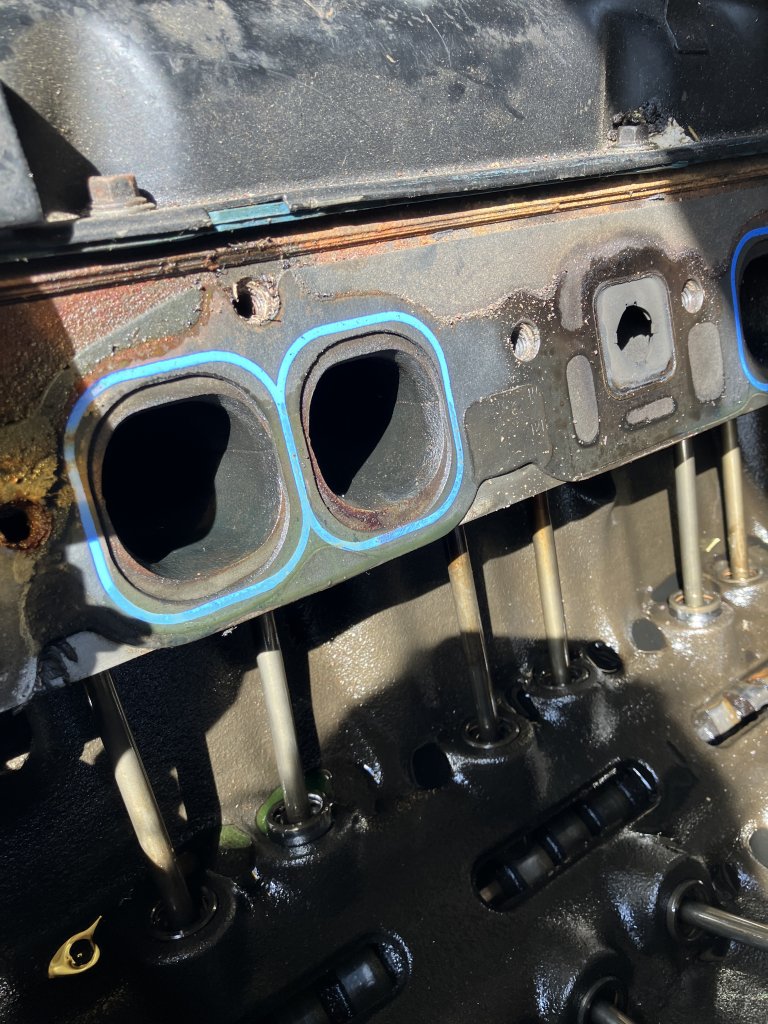

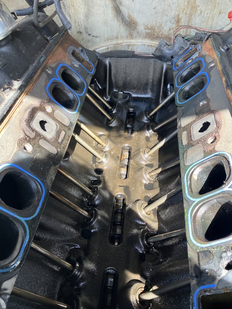

After suspecting that my oil consumption + low vacuum issue was the result of bad intake manifold gaskets, I was able to confirm that that was the case (see pics). Basically I had a leak under the manifold that was simultaneously sucking oil into the intake ports and not letting me get past 15-16 in of vacuum (stock motor). It looks like it just wasn’t sealed on both sides at the bottom so I’m weary about just putting new gaskets in since something is telling me that both bottom areas not sealing is a sign of a bigger issue, i.e. the manifold not lining up with the intake surface of the heads. Is there any way to verify that a new gasket will seal?

Enough of a difference to cause this much leakage?

Specifically where are you seeing evidence of leaks? You didn’t post pics of all of the ports but the blue sealing rings look to be intact and I don’t see any oil trails running across them.
The intake pic is at such an angle I can’t really see the gasket imprint on it.

The last pic is the intake but they’re still awful.

Sorry for the dogshit pics. But the lower part of both gaskets is wet with oil. Oil is also fresh because I’ve been having to constantly refill as I drive. I checked all 4 surfaces for flatness and they’re true as far as I can tell. Also no machining on heads that I’m aware of
