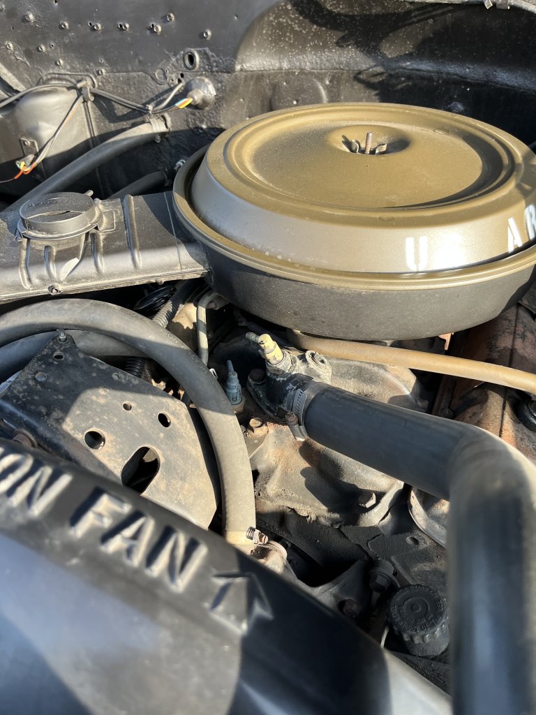

What thread sensor is

Sorry! First time on here. What size sensor is this blue gauge in the manifold to the left of the thermostat housing? Thanks! I have a 1984 K20

The blue colored sensor is a TVS, (Thermal Vacuum Switch). It is used to switch vacuum on or off as the engine warms up. On your truck it looks like there isn't any vacuum hoses hooked to it. Someone has disconnected it's use. Now it is just plugging the pipe port in the intake manifold coolant passage.
The pipe size is either 3/8" or 1/2". There should be a vacuum hose decal on the radiator support or air cleaner that shows all the vacuum hoses your truck was built with.
The temperature gauge sensor is usually mounted in the drivers side head. It has one wire connected to it.
