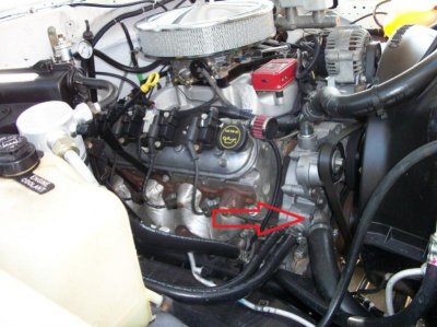

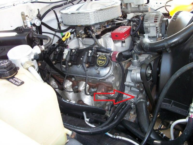

No. The thermostat on LS engines is in the neck of the waterpump on the bottom hose.
99-02 have the thermostat integrated into the neck, have to buy the whole neck.
03+ have the thermostat in the neck, but it's removeable.

aji is correct, a whole bunch of the newer cars and trucks are putting them in the lower hose
