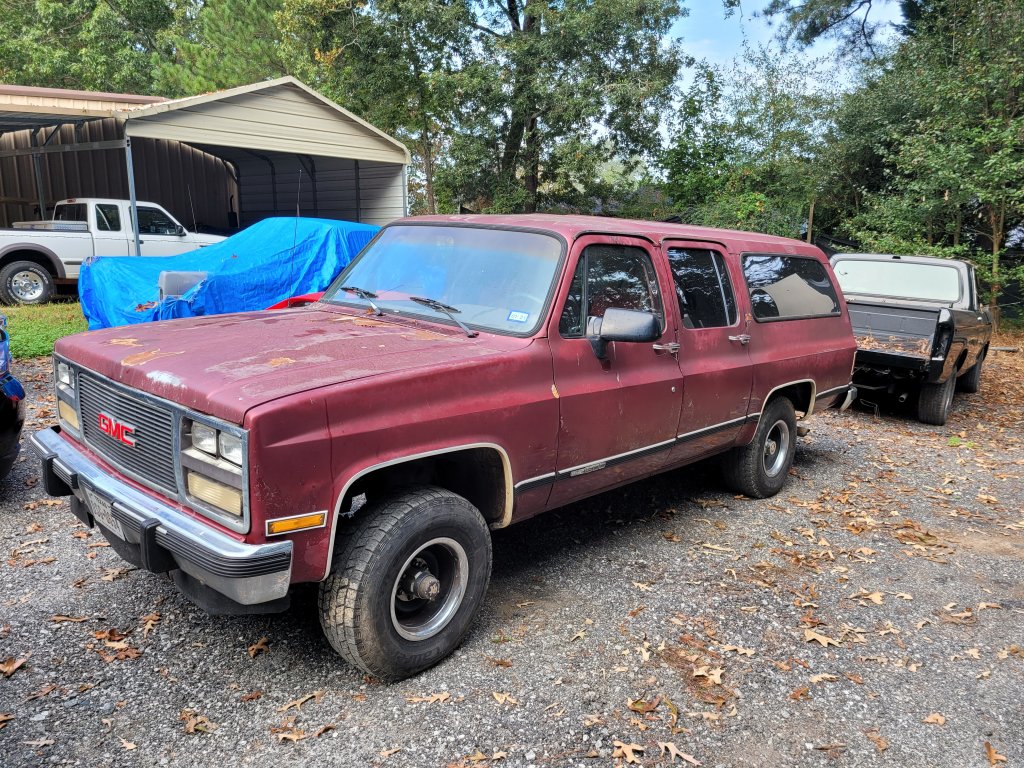

rt66paul
Apr 16, 2016
230
109
California
paul
1991 suburban
2500
7.4
I considered putting on a roof rack on mine and in looking it over, I came to the conclusion that maybe to best mount point would be to drill holes through the side pillars near the shoulder harness mounts, bend some 3/16 stock and cut and/or weld to fit. If you want a big rack, there are 3 pillars on each side. Seal the plates and any wiring to the outside with rtv or some type of sealing putty. Make plenty of room for wires for off road lights, camp lights, outside plug and for future solar panel(s).
A rack that size could hold some extra tires, gas cans, a couple of storage boxes or a foldout tent. Bolting to the pillars would support as much weight as the truck could carry, but it would be a little top heavy. One hell of an Urban Assault Vehicle.
I saw one that was made to hold a film crew getting live action stunt shots, that is how it appeared they did it.
