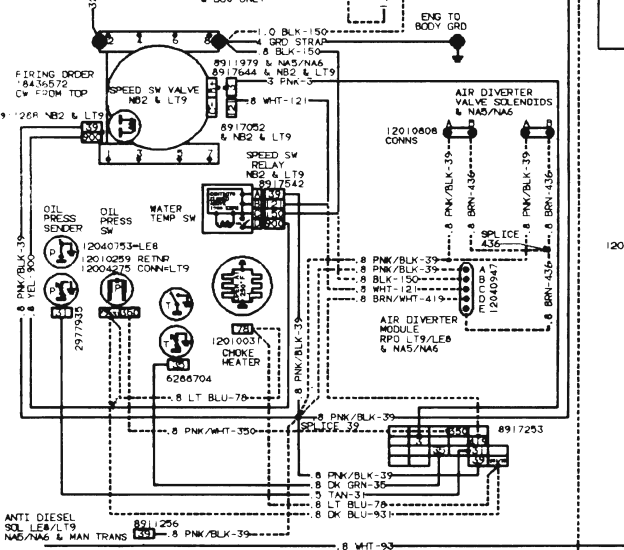

As I am in the process of rebuilding the engine in my truck I wanted to clean up the wiring while I am able. My truck has all of the emissions stuff deleted (AIR smog pump EGR etc). I want to delete the AIR control module. I see the AIR module feeds the distributor from the white wire. Looking at the diagram I believe If I just splice the white wire to the distributor with the white/brown wire that feeds the AIR module that should be enough to eliminate the module. Any thing I am missing here?

I'm with you really. I have no clue how the AIR module works or any of that. It just appears the white/brown wire is the 12volt feed to that module and the white wire to the distributor plug. So I think just splicing those two together and bypassing the module would do it. Currently all other wires from the module are cut.

An A.I.R system (Air Injection Reactor) used a belt driven pump that injected fresh air into the exhaust manifolds via tubes right next to the exhaust ports. The idea was to burn off any gases that are a product of internal combustion. I didn't know the pump had an interface to the distributor, but I never did work on an engine with the A.I.R. system. If your diverter valve is tied to the distributor, I don't know if it was sending info to the distributor, or vice versa.
I just found this description of a diverter valve, but don't know why it would be tired to the distributor:
"To prevent the startling and potentially damaging effects of the explosive combustion of this raw fuel, a diverter valve is used. This valve senses the sharp increase in the intake manifold vacuum resulting from the sudden closure of the throttle, and diverts the air pump's outlet to atmosphere."

There are DIVERTER Valves and then there is a thing called a GULP Valve.
The Diverter valve sent excess air into a sorta muffler on the side of the A.I.R control valve where it was dumped out to the atmosphere - ostensibly quietly as the muffler was full of fiberglass to keep the noise of the tri-bladed pump vanes from being heard.
A GULP Valve, just allowed uncontrolled atmospheric air INTO the exhaust flow during deceleration and that was a big problem.
---> This design was good until the carburetor developed interior fuel control problems and would let excess fuel still flow through the intake and out the exhaust, basically unburned and ready to explode - and DID explode - usually in the muffler.
Many mufflers exploded/died when that happened and GM did away with the Gulp Valves pretty fast!
To your statement -----
There never was any electrical connection from the A.I.R. pump system.
I've explained the 'why' of a Gulp Valve and how it was quickly replaced with a Diverter Valve ..... and I restate ---> there never was any electrical connection of the A.I.R. pump, diverter valve or any other sensors (of which I cannot remember any) and the distributor.
ALL changes in smog pump discharge were controlled by a vacuum signal from a modulated vacuum supply and a manifold vacuum supply to correct the position of the pump discharge into the air injection nozzles at the exhaust ports.

Well maybe I called the module the incorrect name. It is the Emission Control Module not technically the AIR module.
