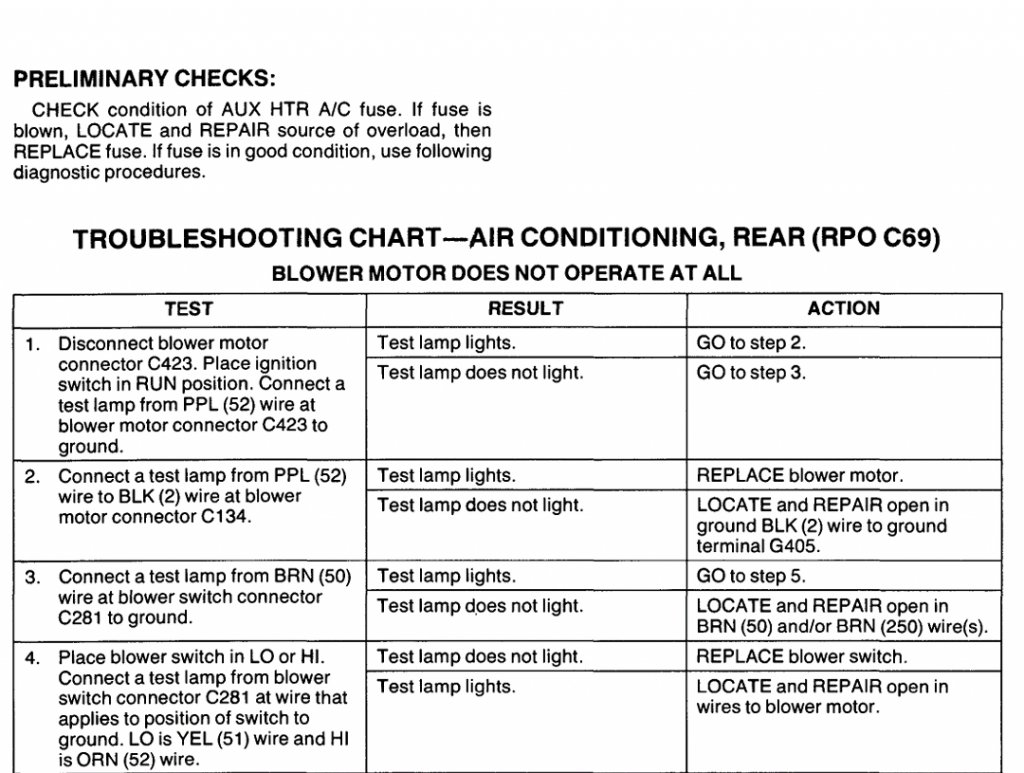

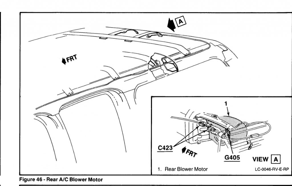

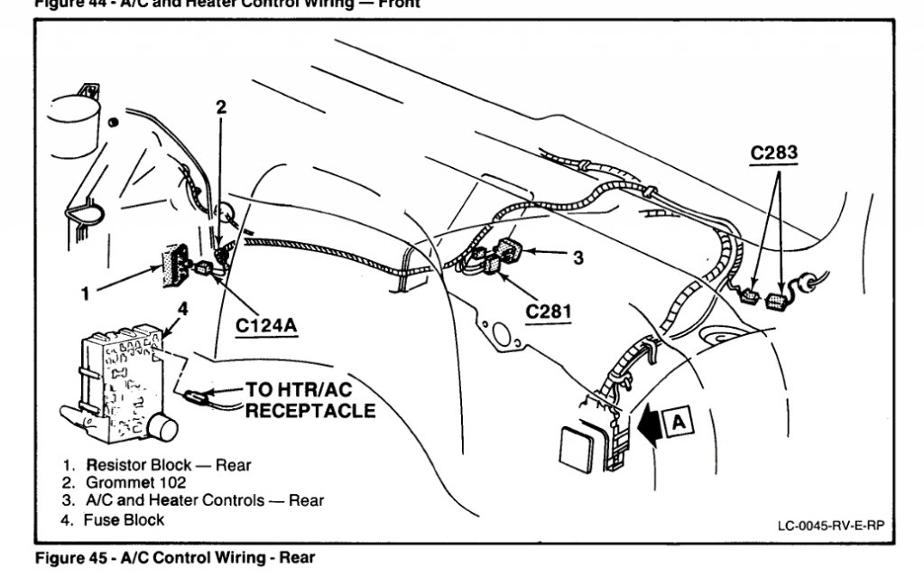

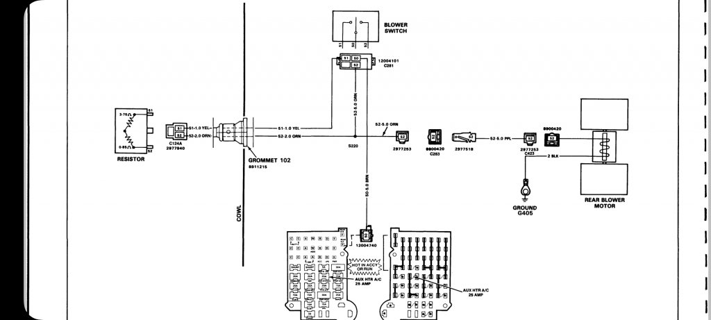

Hi, I've got a short to ground on the rear ac blower motor. I’ve checked the motor itself and it runs fine when i jump it Question is how is the wiring to the rear blower motor routed? Thanks Mark

did you check for power at the switch? pretty sure the wiring runs up in the roof down the driver side.

Thank You very much for the wiring pictures.I did find the wire that runs to the rear blower motor.It’s a pink 8 gauge wire that enters in a hole above the kick panel on the drivers side,and runs along the roof just like the picture shows.As soon as I disconnected it , the fuse stopped blowing.
