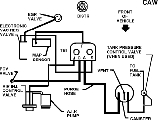

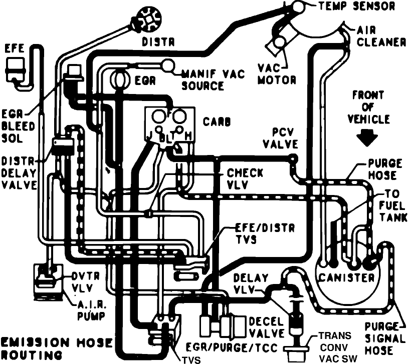

The heater box underneath dash is broken, the blend doors are snapped off and it appears that the previous owner used a heater core that was incorrect for the box. He also did not put the vacuum lines back together correctly. My questions:
1. can you purchase a new heater core box with the blend doors etc aftermarket and where if anyone has a link?
2. is there a vacuum hose wiring diagram anywhere to be found ?
3. does anyone have a heater core box they want to part with ?
Thanx, Kwick

This might help.
