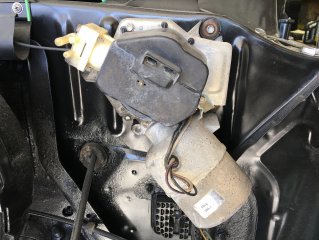

Stock 1977 motor....

....same 1977 truck with a 1978-up motor from O'Reillys w/my new firewall wiring....
