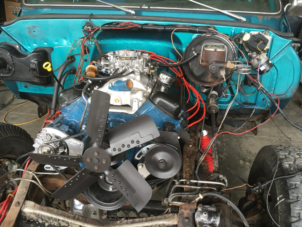

Chime in. I have an 85 6.2 diesel, needs new injector pump, but truck is quite nice otherwise. Here is a pic. Want to fix the pump and run it this winter, why?

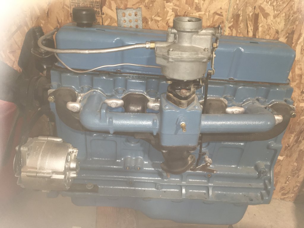

Here is the 73. The 454 is excellent solid motor, has about 375 hp. with the 350th that I built, still going strong. I am heading to Bonneville in a few days, but the truck's fuel mileage is less then desirable, 4:10's, 12.5X35 BF at/ta, shot, so replacing for 16, 285 more a street tread tire. Going down the road @70= 3050 rpm, which the motor seems happy with, but would be much better around 2200 rpm.

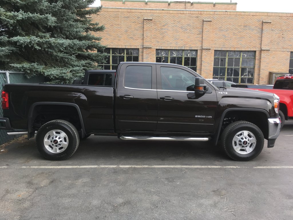

Turbo4whl, what are we gonna do with you! I bought a really nice 4l80e from a 2005 350 van, so it has all the upgrades. Swapping it into the 454 with the Trans-dapt 205 will cost $700.00, plus I have to machine the 205 for the larger bearing, no big deal, I can do that on the BP mill in the shop. I planned on using the Holly Terminator FI setup, as it would control the trans, (extra module). say $2000.00. Also bout drive lives will need modded, again I can do that myself, made lots of drivelines. But ok,ok, my good wife has a 2018 GMC Sierra 6.2, gets around 14-16 regular driving, but freeway, almost 20 mpg at 65mph

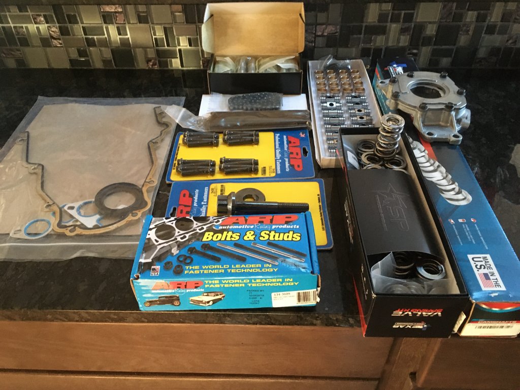

the kicker. I have had this 1998 LQ4/4l80e for three years, and been collecting parts, and it is complete with the 866 ecm, and complete wiring harness. I would remove the bed and front end, clean the frame and paint, (nice, surface rust only), use the 87? side tanks, with pumps in each tank, and would need a 62psi switch for the tanks, speedo upgrade, and etc. If you have done this, school me, (my wife loves me when I say that to her), don't know if that will work here. Here are the parts I have so far: Pic #3 trunion upgrade.

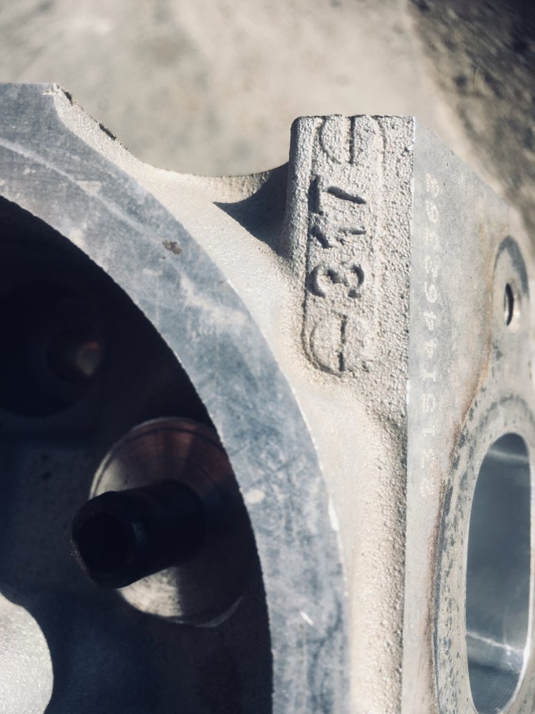

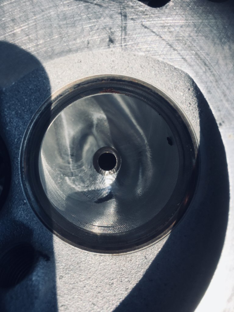

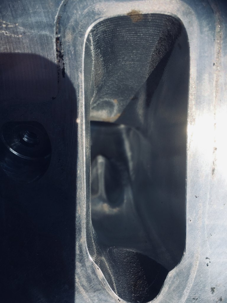

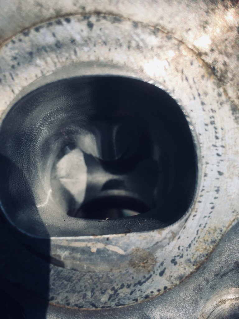

I also have iron heads, so will replace with some 317 aluminum heads that I sent off to K2 to have them ported flow 310 and 185CFM.

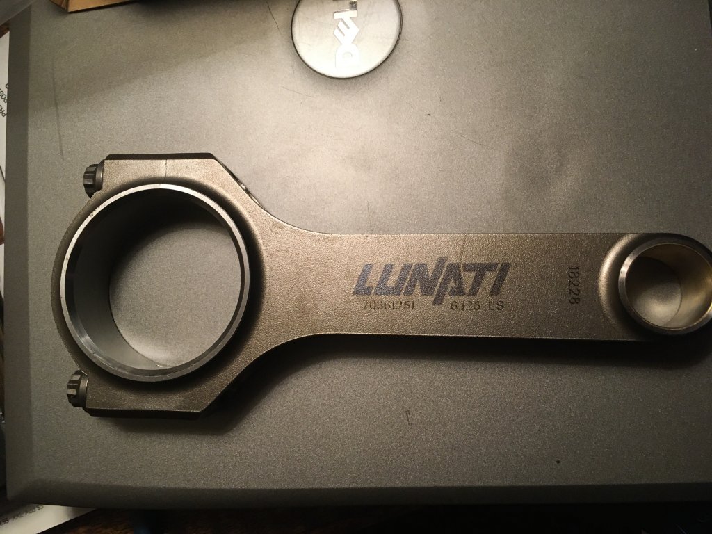

Here are the rods: The only other weak spot is the pistons, which will be replaced with something like these:
2618, they require a bit more clearance, but I want to (maybe) turbo soo...have a BW 460 rebuilt turbo setting in the shop for this.

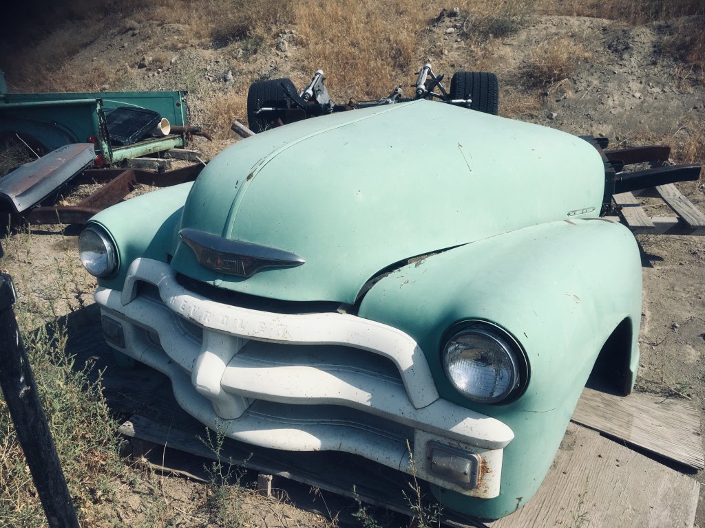

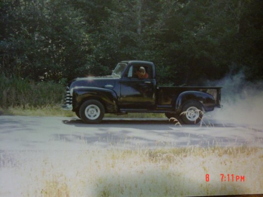

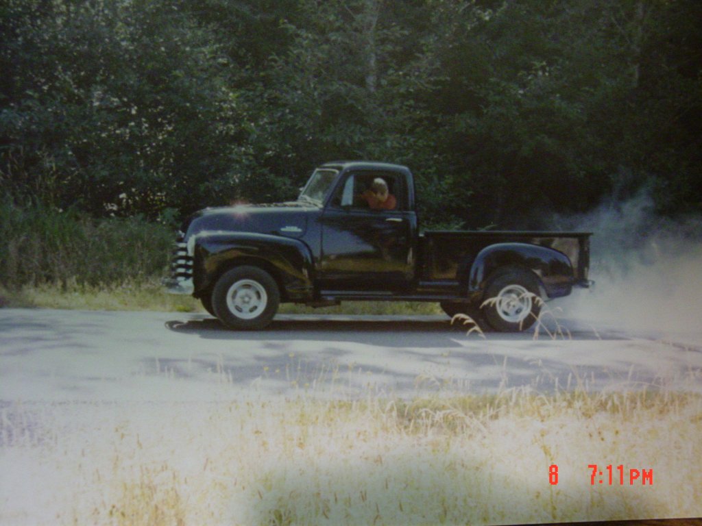

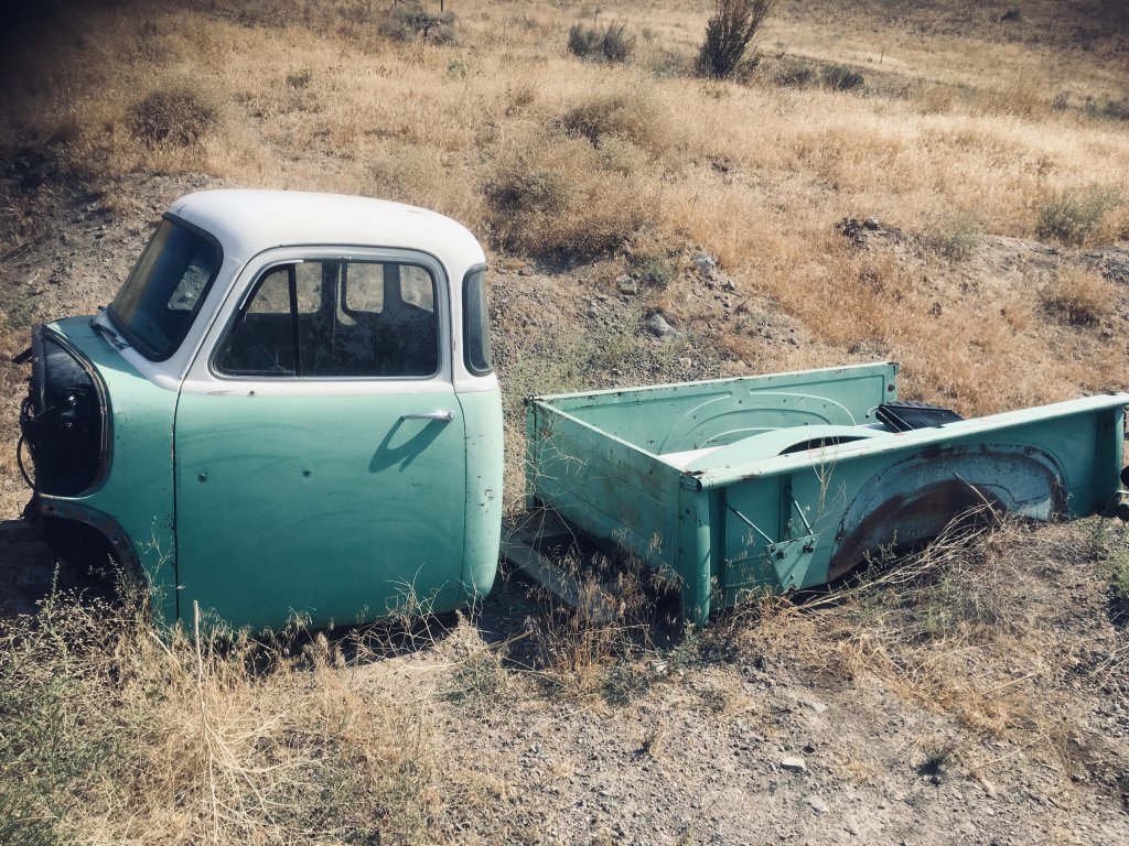

I love this truck, and though the body is rusted some, still has good bones. What is he gonna do with fo fiddy fo? Glad you asked. It will probably go into the 54 3600 pickup I have been messin with for years. (Has independent front suspension from Jim Morrison Racing, D60 Tri four link I built, with Strange SS 35 spline axles, 1410 u joints, another built by me 4l80e, has a nice ring to it). It will be rude, fast, and my cruse truck, and will make chevy owners PROUD. should put me into the high 9'S, so roll cage fast. Want to take to B-Ville, shoot for 130, maybe 150 MPH class. I am 68, not as much time left as you youngsters, though I am not as old as Idahovette!) While I have had a 350, in the 54, here is the current and original motor. 2nd pic my 53, 3rd is the 54.
