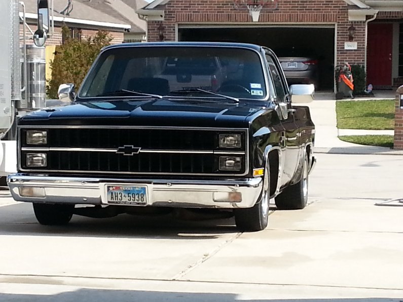

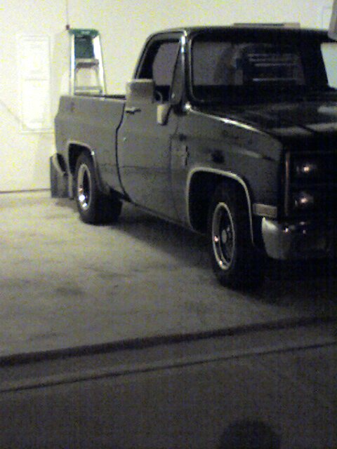

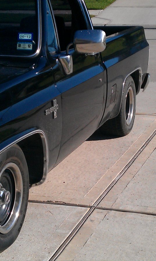

If your going to go lower than 4in you need a 5in bs.

I ordered the 5" BS. Thanks for the pics! Clean truck.

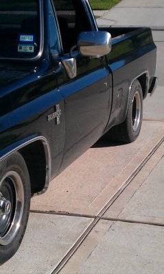

15x10, 4.5 back space, 285/70/15 BFG tire, flip kit plus 2 inch shackles. Had to get creative with the fender lips. If I had to do it again I would do 4.75 back space to help a little.
Fronts are 15x7 with 3.5 back space and a 235/70/15 BFG tire. I guess I'm old school with the 15's, I just don't get the whole big diameter wheel thing.
