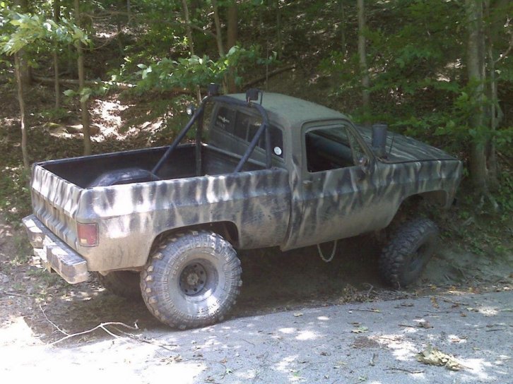

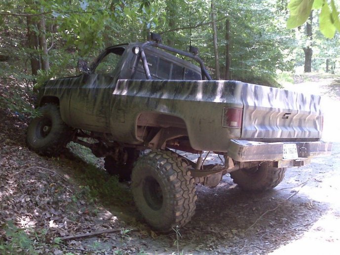

Shackle flip will get you much flex out back, I would probably be ok taking a leaf or three out from under the back of mine to get a little more stuff in the fenderwells. Drill the rivets first and you can cut the heads off with an air chisel then pop them through the frame with the punch attachment on the air chisel. Best thing you can do for offroad-ability is lockers. Don't forget to address gearing, find out what ratio it has and if 35s are just going to kill performance. It's an endless thing once you get started. Firebane is right BTW, unless you buy lift springs to add with the rear shackle flip you'll have to run at least a 2" block to make it 6". And Zero Rates help you recenter the axle in the fenderwell since the shackle flip swings the axle forward as well as down.
