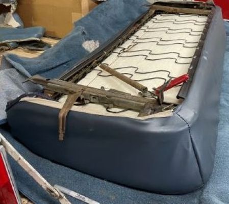

We have the option to use 1 of 3 bench seats. The seat from the truck, which appears to be a 1975, a seat from a 1980, and a seat from a 1981. I’ll put the details about each seat down below followed by our questions, but our main question is which seat should we use? I know there are folks on here who know the various seats and differences well, hoping to get your thoughts.
  • does not fold
  • some broken springs need repair
  • foam needs replaced or repaired
  • folds, and has a latch mechanism to lock upright.
  • springs look good (same type as 75)
  • folds, but does not appear to have a latch mechanism (it is currently not in a cab)
  • springs look good (different style springs than 75 and 80)
  • slots for seat belts

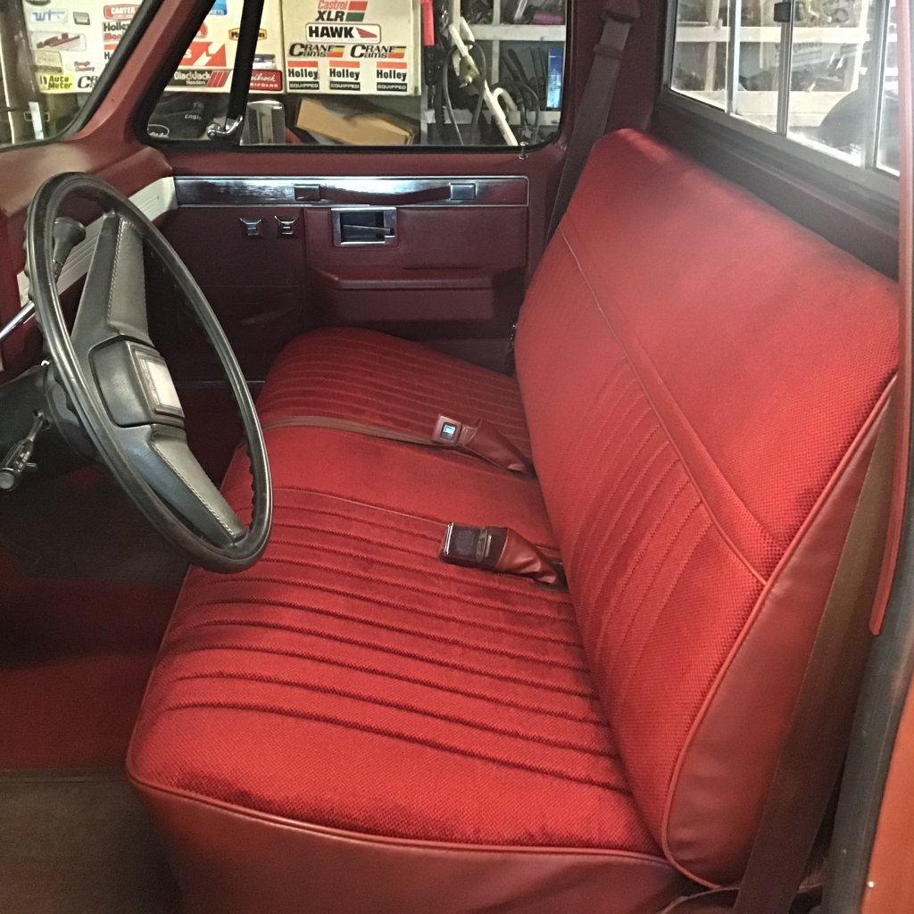

Although I LOVE the ‘81 I think it is special stripe pattern. Can’t find that stuff anymore. I was attempting to get my upholsterer to sew one up like that and he just laughed and asked how much I wanted to spend because he’d be sewing for a week!
Also learned something valuable from him. Said you never want “raised” surfaces running F to R that protrude at all. (Picture overlaying stripes on top of the base material without sewing them In flush.) Said your pants pockets will catch on them every time you get in and out and tear the seat up in no time.
