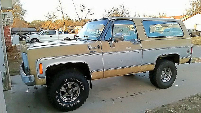

My '75 has a 2.5 inch lift and clears 33x12.50R15 NP.
That's juuuuust about as tall as I care to go without having to use a step or some other bolt-on bull stuff what I hate and would NEVER put on my truck.... I'm six foot tall and can still get in it.
Next size bigger (4 inch lift and 35s) gets an easy 2 inches straight up and I dont want to do that without a step of some sort, so I learn to love that high. This is likely maxXxed out FOR ME. Top of the wheel at the bottom of the sill....it's juuuuust right, Goldilocks. The bottom of the bed is visible at the top of the tire...everything is correct.:imo:

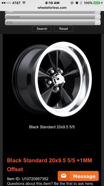

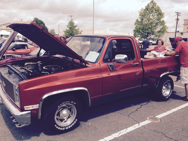

I have a 1985 chevy c10 with stock suspension. Here is a pic of my truck and here is a pic of the rims I'm thinking about. The size I was thinking was
Rims
20x9.5 (back)
20x8 (front)
Tires
295/40/20 (back)
245/45/20 (front)
