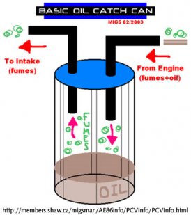

Huh I have a pcv on both valve covers with a t going in to carb base...so its just sucking engine gasses no clean air going in... also what do you guys think of oil catch cans...usefull yes..no..
SO you are not venting the crankcase with that set up. You need fresh filtered air to go in one side and the pcv valve on the other routed to the carb base.
Im not sure what an oil catch can is?

Ok ill change that so it gets fresh air in one side and pcv on other side..oil catch cans trap oil in the gasses so the oil dosent go in to carb and dirty it up..

If you need a catch can on a stock vehicle you have MUCH MUCH larger issues.
