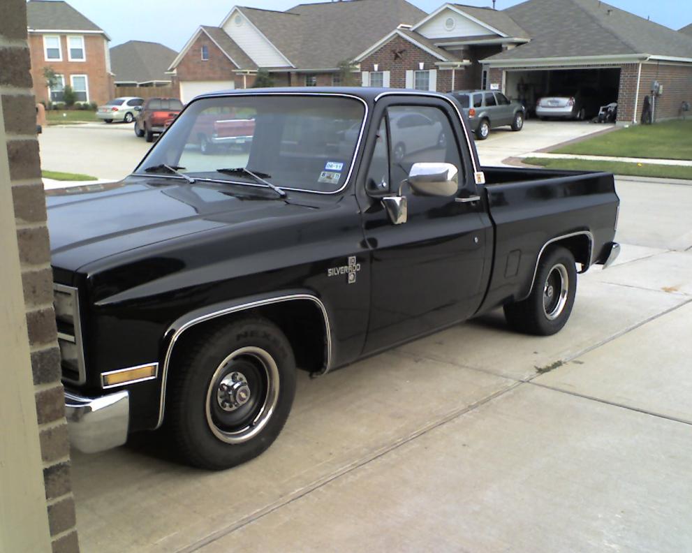

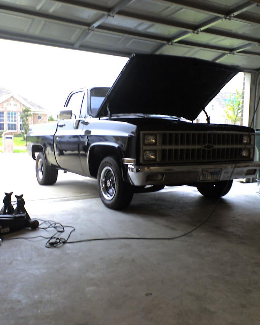

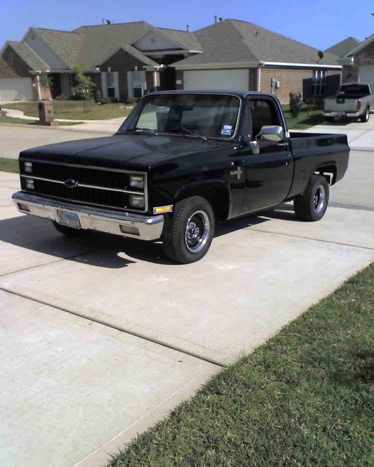

These are pics of 15x6.5 ans 15x8 rallys with the tire sizes in the quote.

Thanks jk...i like those back 295's....
