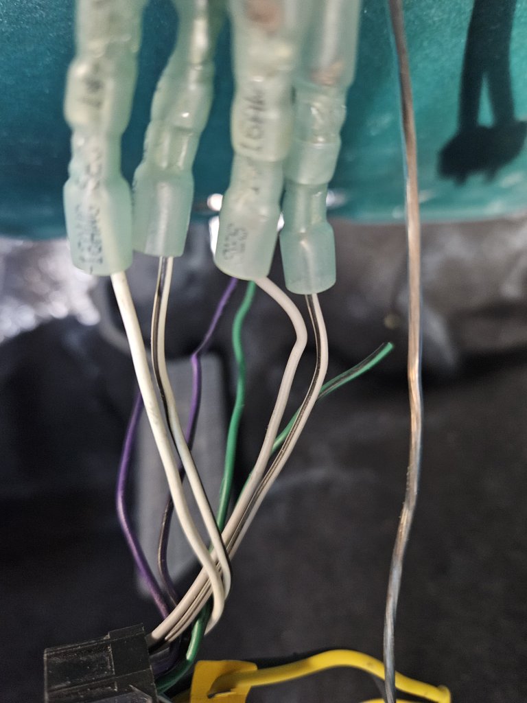

I need help with this please I think I have the amp right and the power but the rest of it is Latin.
I have 2 speakers behind the seat and 1 off the amp.

Head unit Grey and white are front speakers,purple and green rears. Black stripes are speaker negatives.red is keyed power,yellow is constant power,blue is the amp trigger black is ground. I have no idea about tge rest of that mess.more and better pics maybe would help. I have no idea what you've connected to where on that amp.

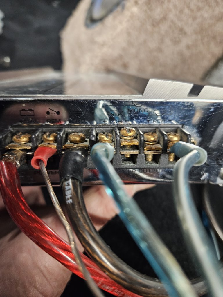

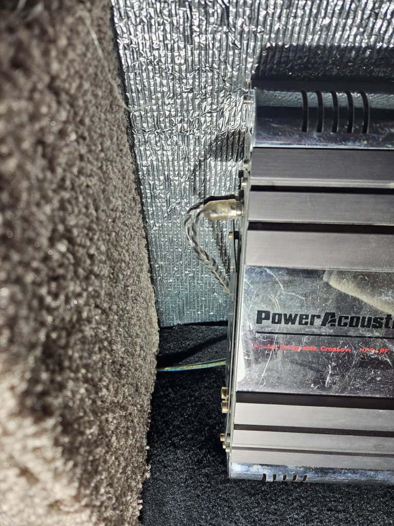

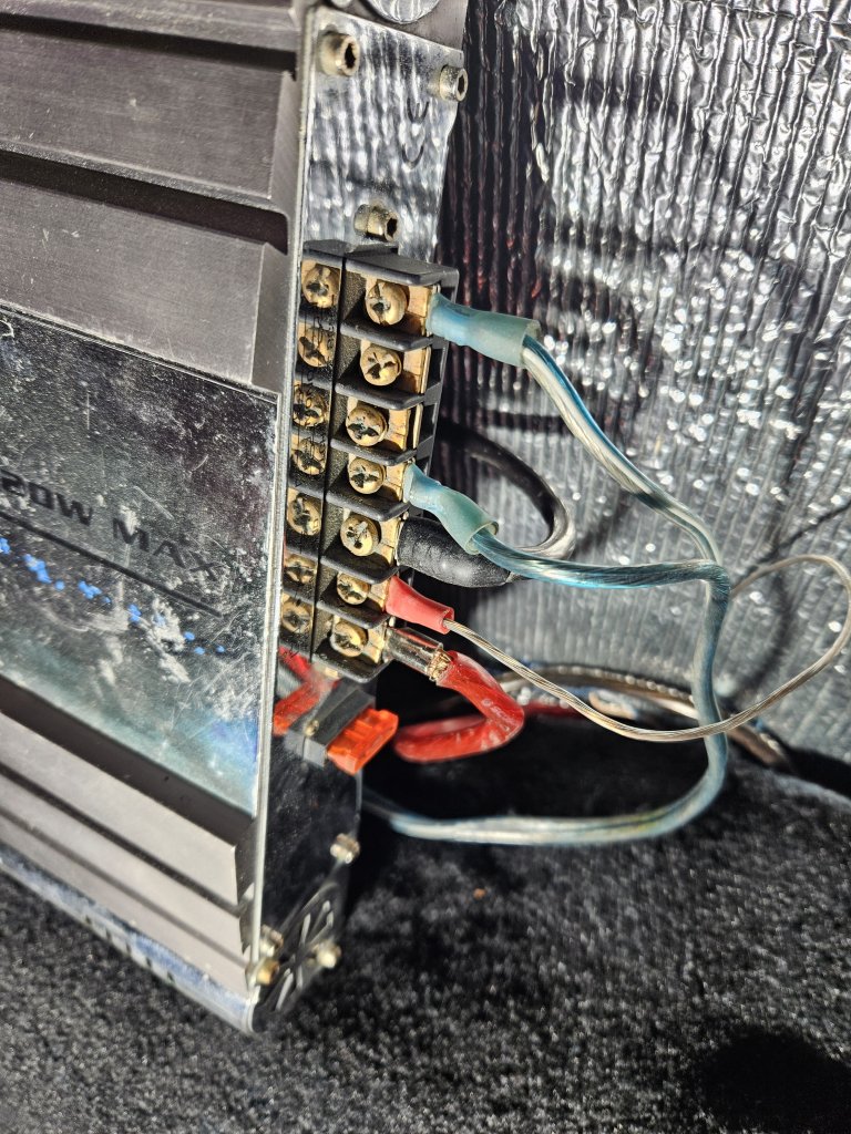

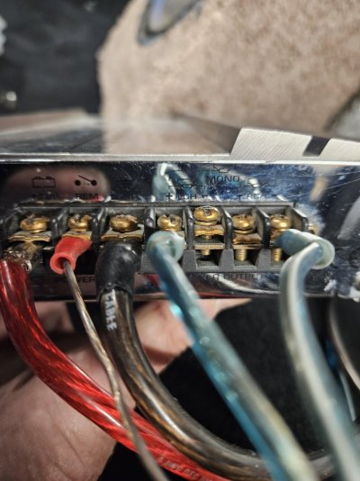

Thanks for answering, I will take pictures of the amp with the connections I have.
I totally agree on the mess
What would you like for pictures on the other wiring

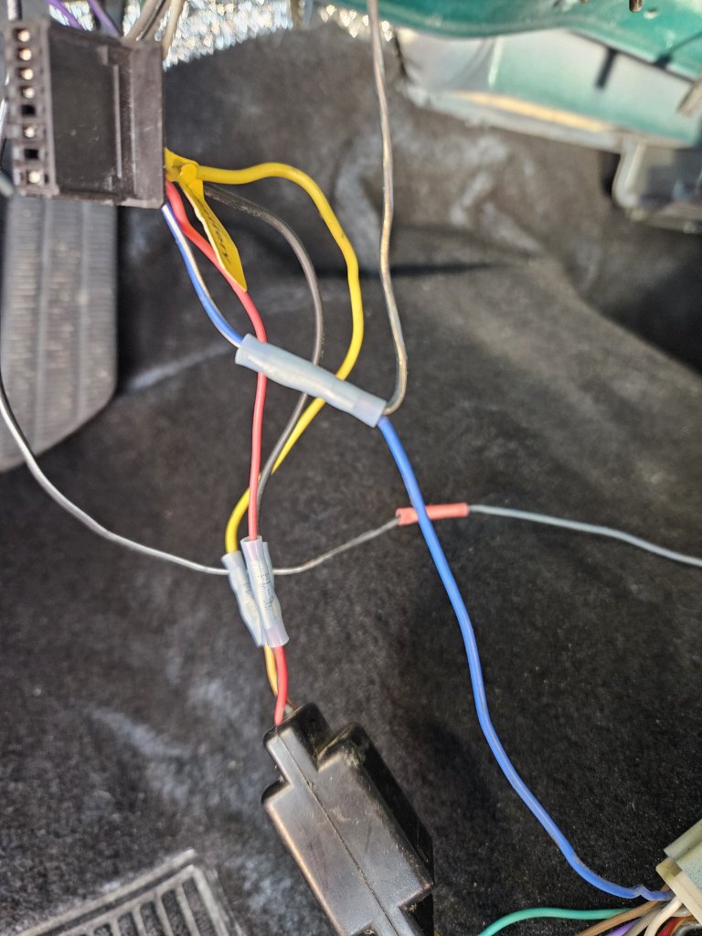

I don't get what the black box is.

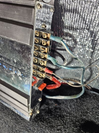

The yellow is on constant the red on keyed and the ground is on buss bar. The red wire is on 12 vote. Power goes right to the battery, the little wire says remote and is hooked to the blue with white stripe. Wire coming out of the plug. That plugs in to the stereo.
The black wire is ground and I grounded it to the cab.
The 2 blue speaker wires are hooked to write, channel and le
ft, channel, negative and positive. And they go to the big speaker in the back.
The other end of the amp has just two wires line input left channel right channel

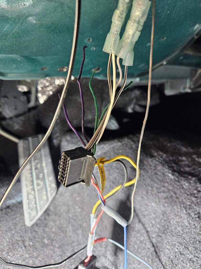

The second photo is of

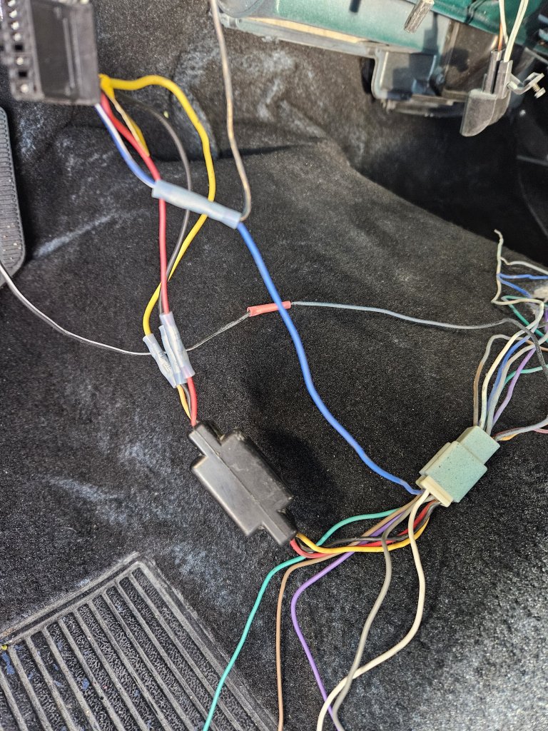

Where the remote wire attaches to the harness

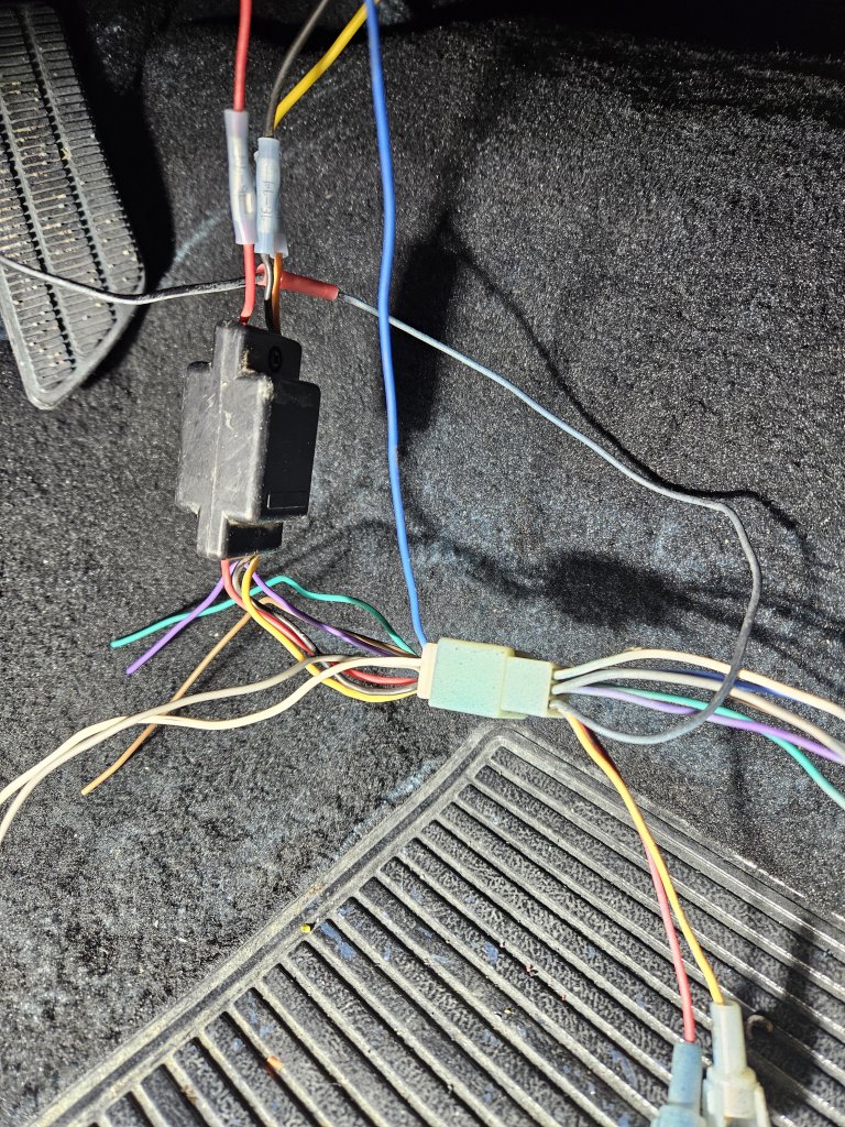

The last photo is the speaker wires to the 2 speakers behind the seat.
I hope this helps, and honestly, I really appreciate this

My suspicion is that he little black box with the red/yellow/black(or brown hard to tell in photo) wires going in and out is a form of either short-term rechargable battery or a capacitor, the intent being that you don't lose the clock/programmed stations/EQ settings/etc if you disconnect the truck's battery for a short period of time. I had a Kenwood head unit with that once, it was a cool idea but then the whole unit failed for other reasons.
