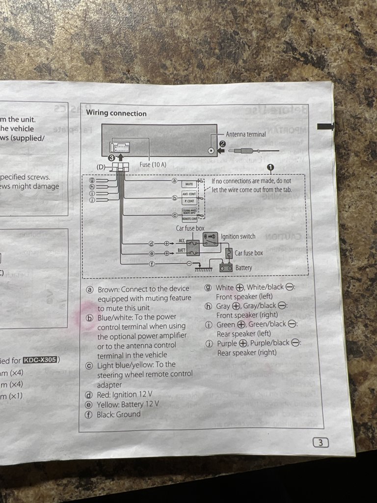

so no instruction booklet in the stereo box? Maybe on the web. Pretty much explains where they go like below.

Yea I got instructions I connected the black to black and red to yellow that’s ignition switch and the yellow didn’t know what to connect it too

I have those three idk which connect where I tried no power on the stereo but currents is going through

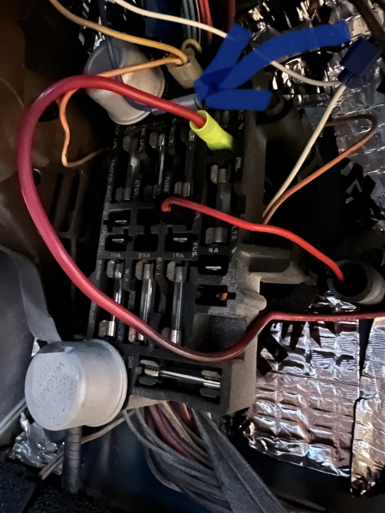

Remember there are TWO different power connections to the new stereo if it is digital. The other power needs to be a battery hot connection. This is for all the memory such as presets and clock while truck is off. Takes very little power. Remember in an earlier thread you were told to connect this to the fuse box on a constant hot connection. I think I attached a picture of our hot connection
Blue arrow/ blue wire battery hot all the time
