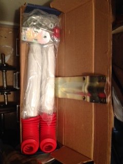

Stabilizers
Well here they are and most likely I will be installing them tomorrow. They came with the boots and everything and there's two!!!!
