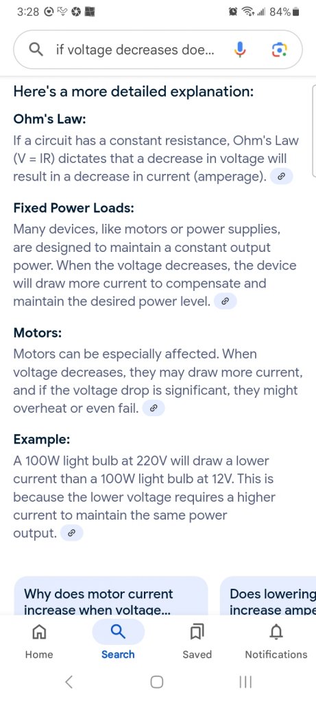

I still see a possible voltage problem,that's causing the same problem with a second starter. Now if you look back in vehicle history,look at the gauge of the wiring in 6 volt cars,it was huge to carry the amperage of a 6 volt load,they switched to 12 volt and the gauge dropped substantially, they pump 120 volts to our house,we run compressors and air conditioners,etc,etc. None of the wires in our house are as big as the battery cable that provides power to the starter. Maybe I don't have ohms law remembered correctly,but I have seen plenty of starters that don't disengage, caused by low voltage conditions,I've also seen lots of starters click but not crank due to battery cables causing low volts,Ive never seen an ignition switch cause both those problems on the same vehicle. Anyways IDK I thought it was ohms law causing excessive amperage draw in low voltage situations. So what formula is watts÷volts=Amps? You can all try this at home 1000 watts divided by 12volts equals 83.33 amps, as you start decreasing the voltage the amps go up dramatically 1000 watts divided by 6 volts equals 166.6 amps. Anyway I've seen lots of starter problems caused by low voltage,I always thought it was ohms law.
Yes, you are correct, it is Watts law. To get the same Power(Watts), if the voltage drops you need to increase the Amps. I was not trying to puff my chest out or make you look dumb. I just want OP to get his truck fixed.
If I am not mistaken, the OP had a clicking, no crank issue he tried fixing with a lock cylinder replacement but ended up replacing the starter. After being installed for a period of time the new starter would not disengage. I did not think he had both click, no crank and no disengagement issue with the current starter installed.
No I just didn't understand,I've always thought it was ohms law been stating it this way for 20 years,no on has ever said anything. Now I know,thanks. My money is still on voltage/amperage issue.
