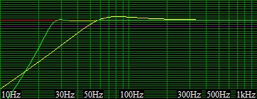

honestly i think a ported enclosure would be the ticket. yes this is possible with the small box behind the seat. here is a plot of my current set up in yellow. its 2 kicker cvt 12's in a sealed enclosure. the green is 2 alpine swr 8's (yup 8's) in a ported enclosure tuned to 28 hz. i am really considering the change myself because you set great low end extension at pretty high decibels. deep loud bass. only drawback is you gotta make the enclosure yourself.
