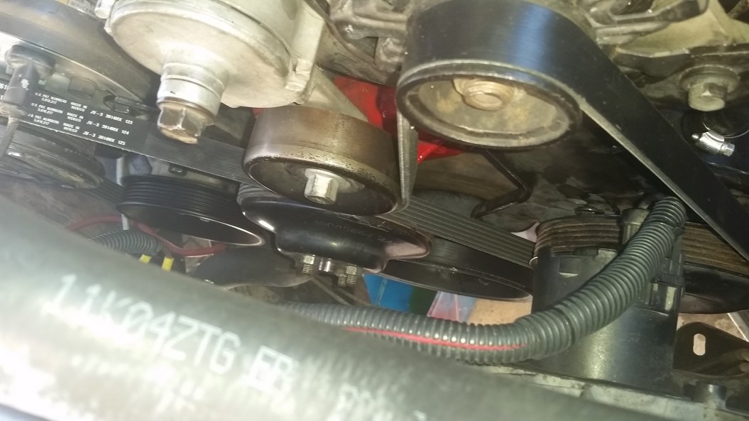

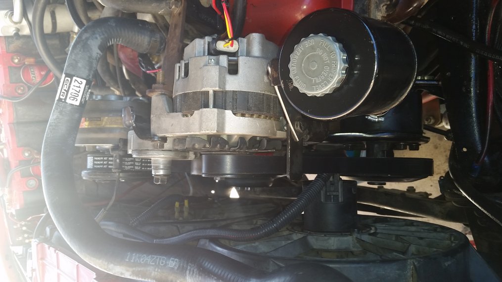

I put 92 bb serpintine on mine works great newer accessories

No it was getting parted out at my brother's work and i pulled it off had everything i nedded i just bought all new acc ..rev water pump ...alt ac then the conversation plugs
