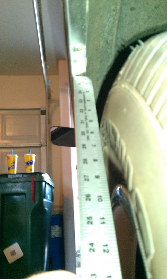

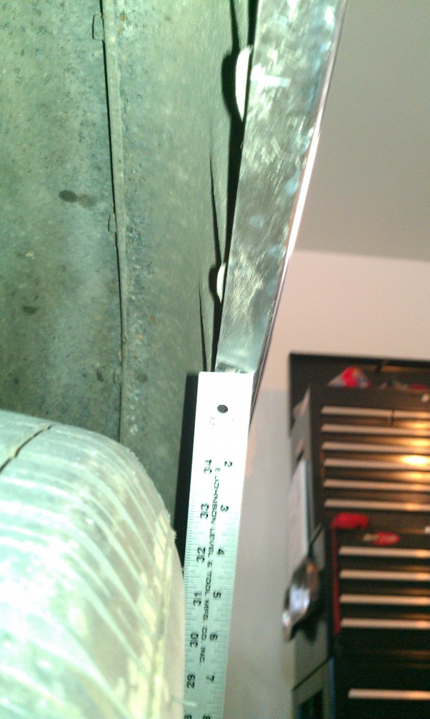

It will be close. This is a 5in drop with 15x10...5in backspace with a 295/50/15.

Well Crap!! I HATE when I hear a rubbing tire!!
Thank you for the Heads up.

You can still run them but dips and steep turns might rub.
