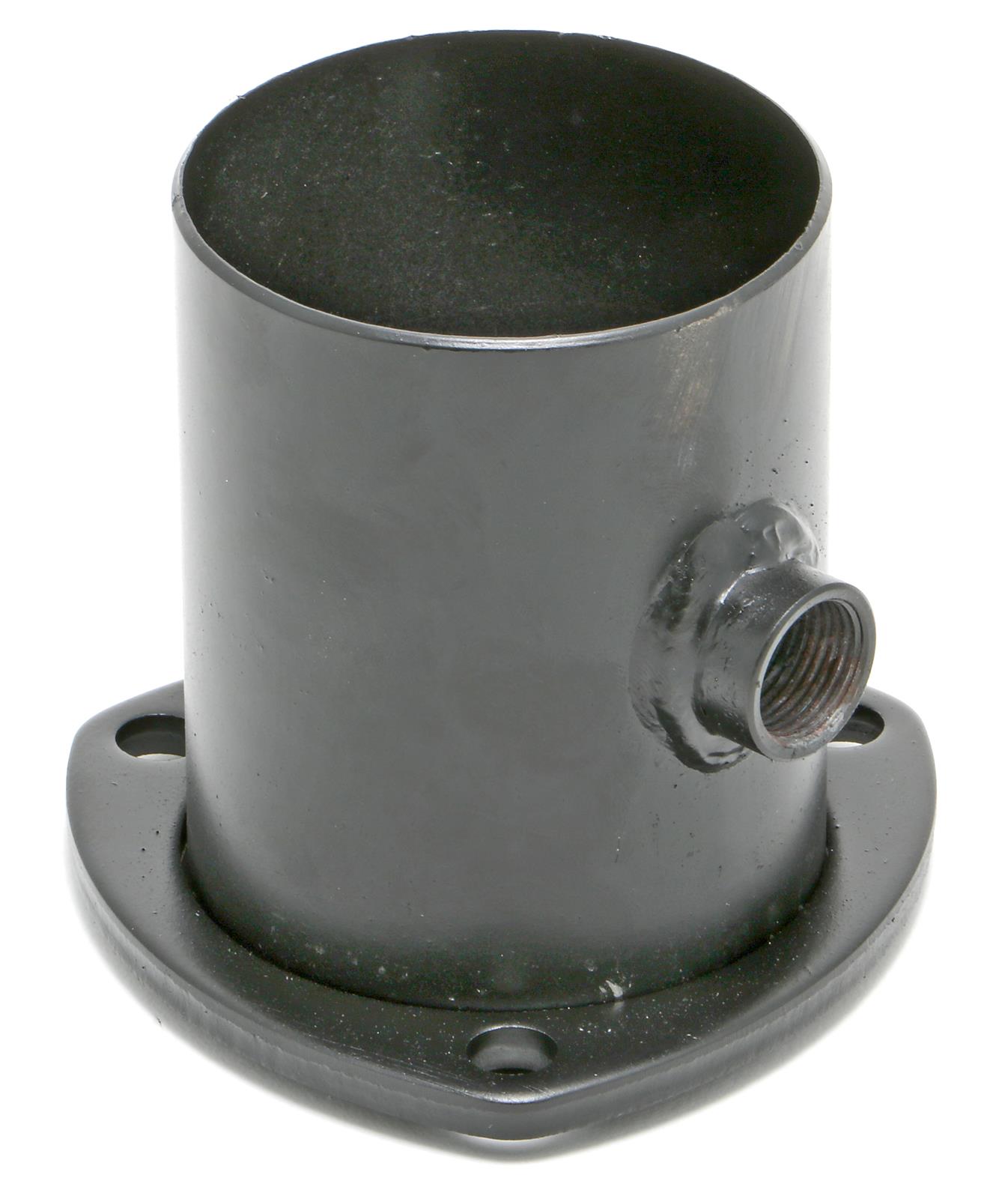

Quick question: the ProFlo4 EFI setup says to put a bung in the passenger side header collector. WELL.....some dumbarse that wears my pants and looks alot like me, mounted the headers, routed plug wires, etc all up and forgot to do just that. Would the world end if I placed the bung in the adapter pipe a mere few inches from the collector? I could swear I've seen adapters come with the bung in them at that location.
Probably a stupid question but one that would typically bite me if I dont at least appear to be worried.
Thx.
32,026
33,043
It will be just fine mounted in the collector reducer.
