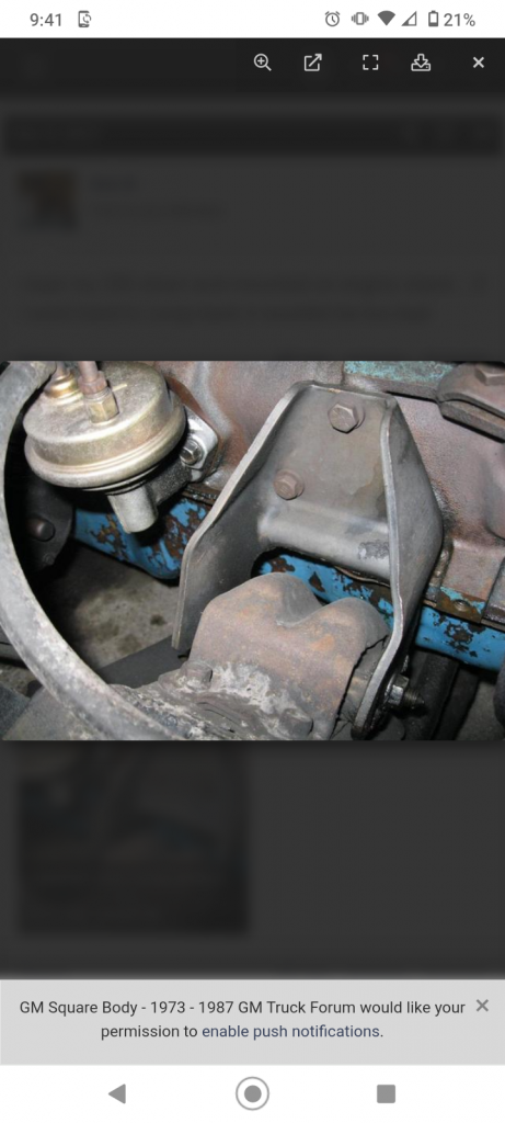

Hey all, so I have an 82 C10 with a blown 350. I bought a 250 inline 6 and have just about everything to complete the swap. I can not for the life of me find the proper motor mounts. I need the mounts that bolt to the block. Any help on where to look would be greatly appreciated. Thanks all

These r the ones I need

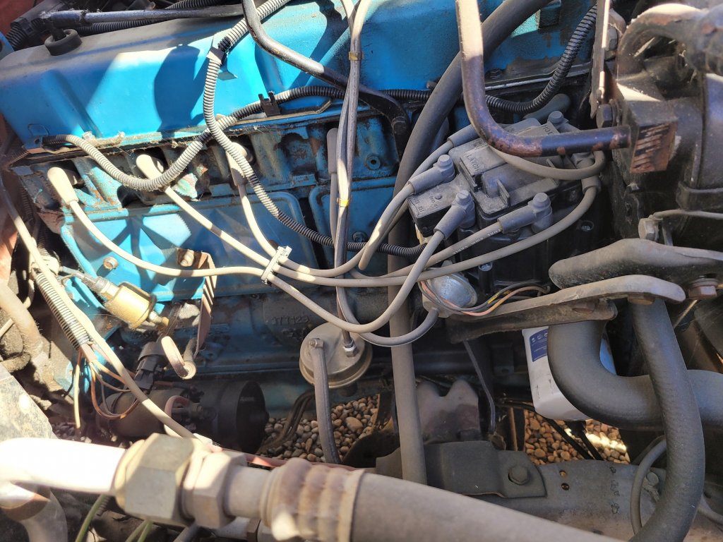

Just to clarify, that is the unique passenger's side mount on a 292. Everything else (194, 230, 250) mounts in the middle of the block where the fuel pump is on the 292.
