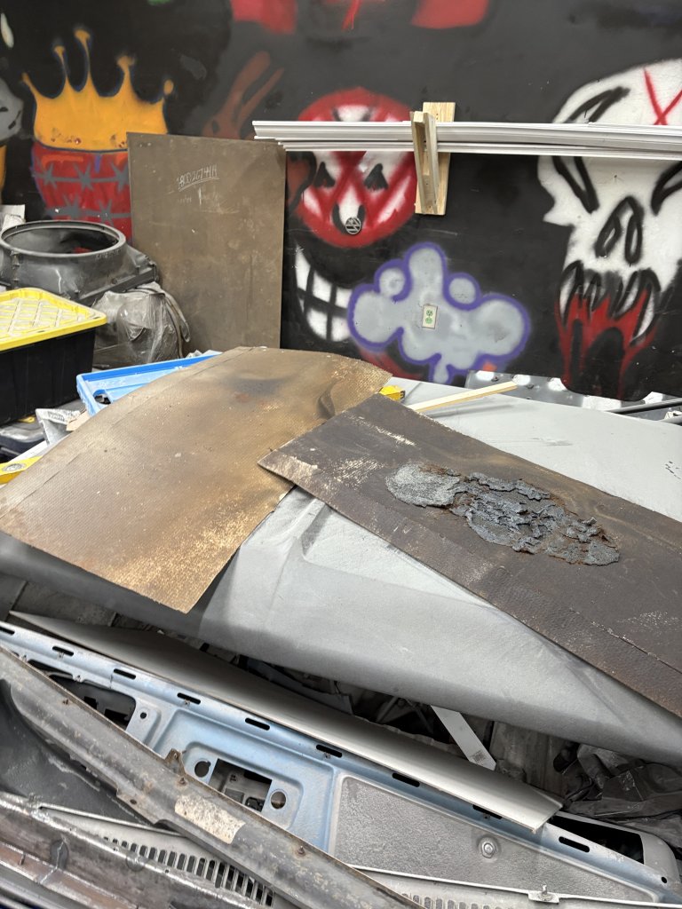

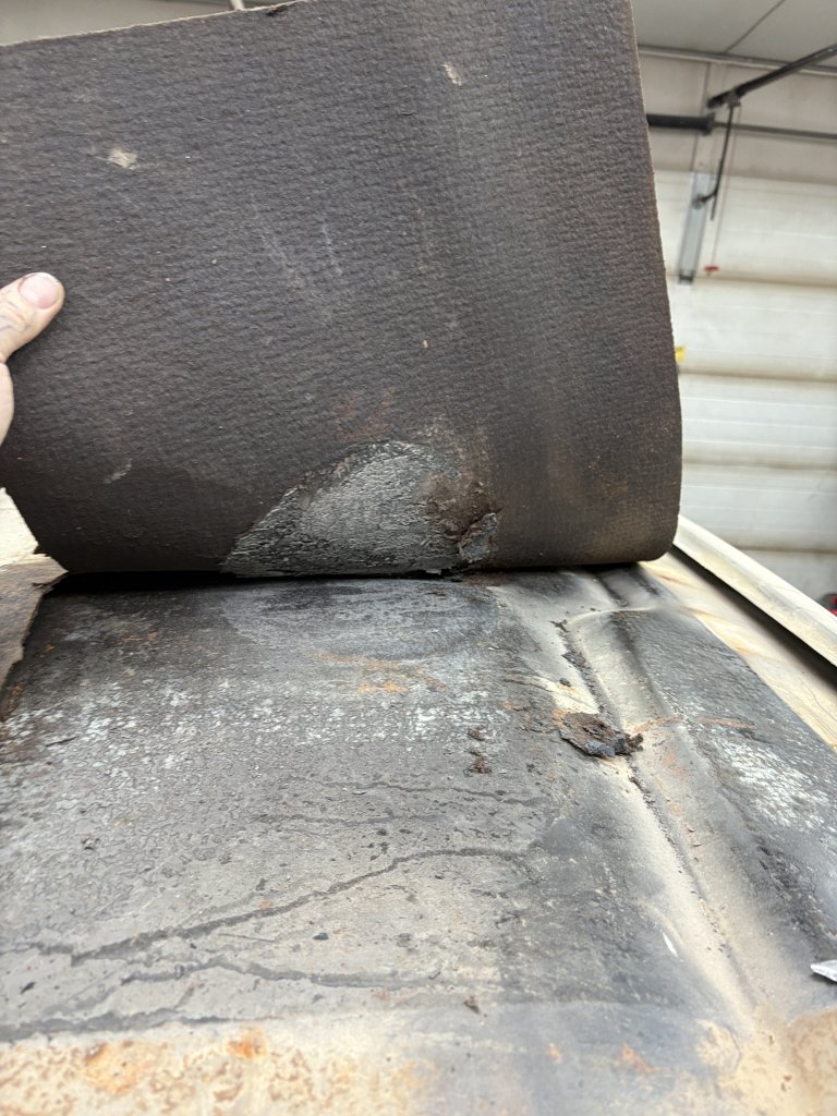

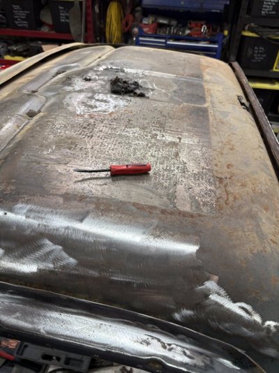

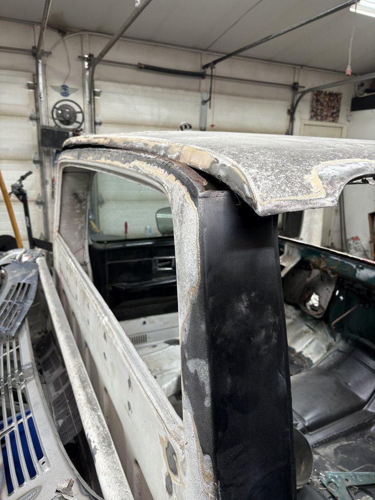

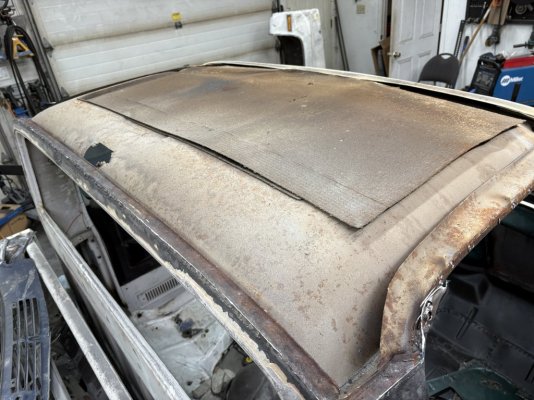

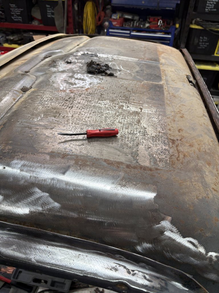

Has anyone replaced these panel spacers with legitimate sound deadening like killmat? I had two layers of it to support between inner and outer panel - going to finish prepping the top side interior roof panel & rust coat - then was thinking I would be able to get rid of a little road decibels by layering the sound deadening material before final installation of the outer skin.
Thoughts are welcomed please!

I'd probably keep an air gap in there. Paint it then maybe a wax coating, like factory did in some areas. Would definitely help sound and temp though. Maybe an aerosol deadner.
4,654
15,388
I would use a rust inhibitor paint and then maybe just put enough Kilmat to match what the factory had. Like Mason said, I'd wanna keep some air gap in there

I was also along the same line of thinking of definitely paint and kilmating enough to build up what was there to, maybe leaving the centre open, put a bit of wax in the low spots, air gap / flow is a good point but with the air you get sound to some respect, curious what factory’s thoughts were on it/ an autobody guys opinions were, I wasn’t shocked, I assumed sound and panel vibrations like the hoods on 67-72 Appreciated guys!

They did the double wall as their "insulation". My 70 hood is awful as well lol.
If truly worried about the roof I would do the inside and then do a headliner. If in the desert you won't have to worry about moisture as much.

It’s the heat that makes me think it would sag in summer, only 90-110°f in summer 35-42°c

A quality sound deadner will not. Especially on the inside of a double wall.
Single wall suburban. We get plenty hot here. Not a single spot has an issue. Floor pans get way hotter but obviously no gravity issues.
