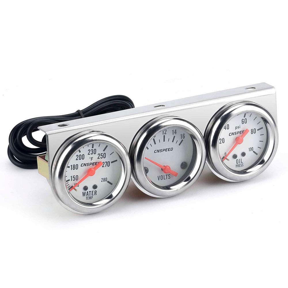

Speedometer - use fee phone app for speed (GPS Speedo)-
Oil pressure - low priority, should be addressed asap.
Temp gauge - high priority, should be addressed asap.
For about $20 you can solve all your problems.
