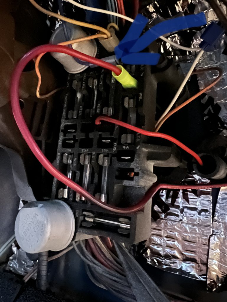

Here is ours. Blue wire with blue arrow

Red to constant power and yellow to key on power. I think blue is to turn on an amp if you have one. If not leave it.
