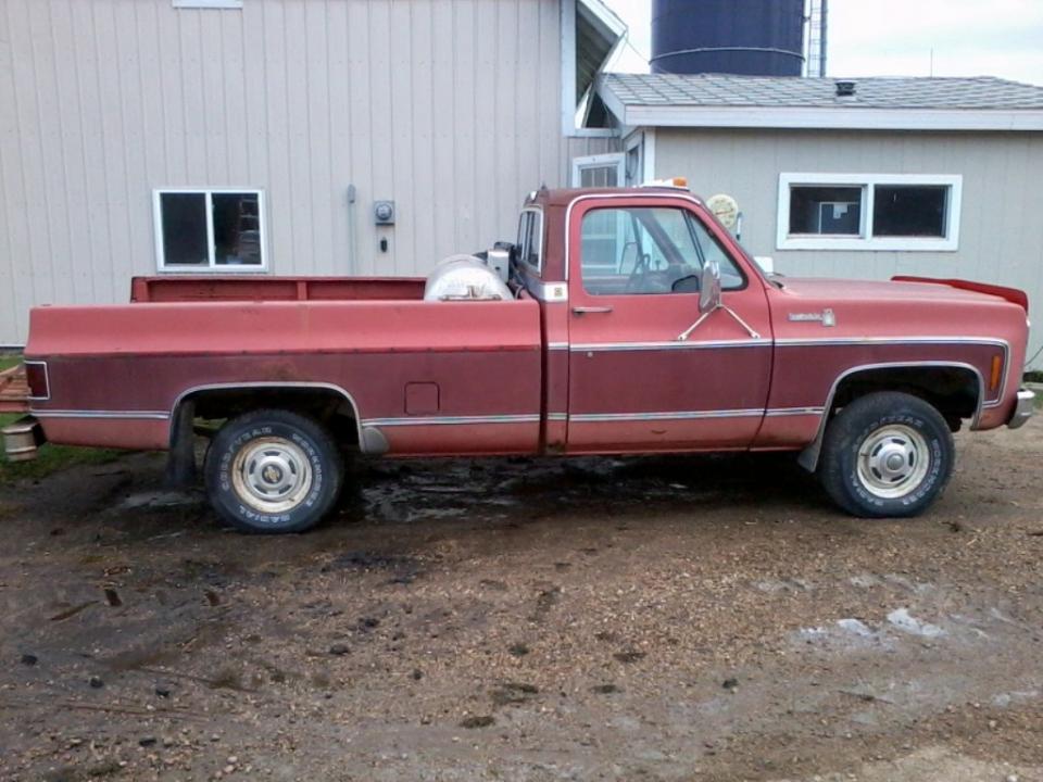

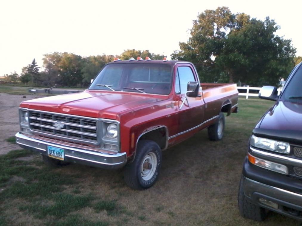

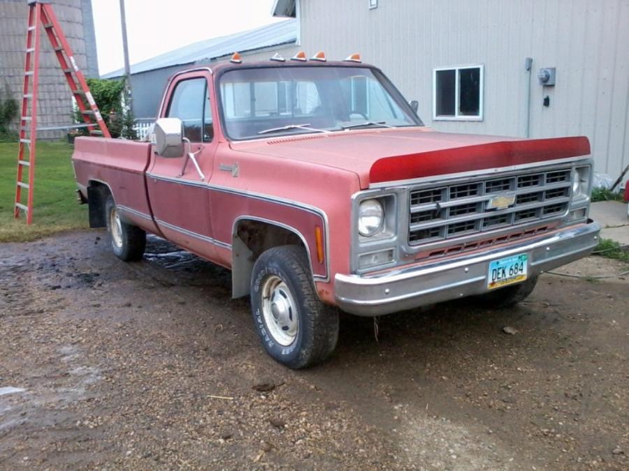

Here's my 79 just pulled out of the weeds and a bath.

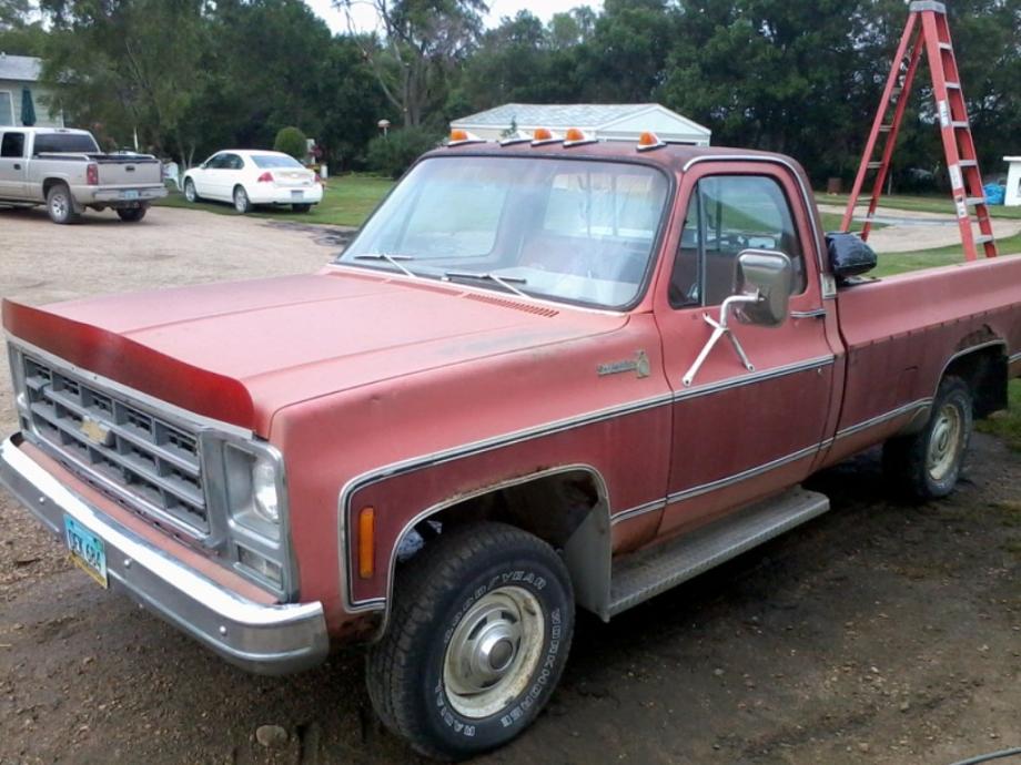

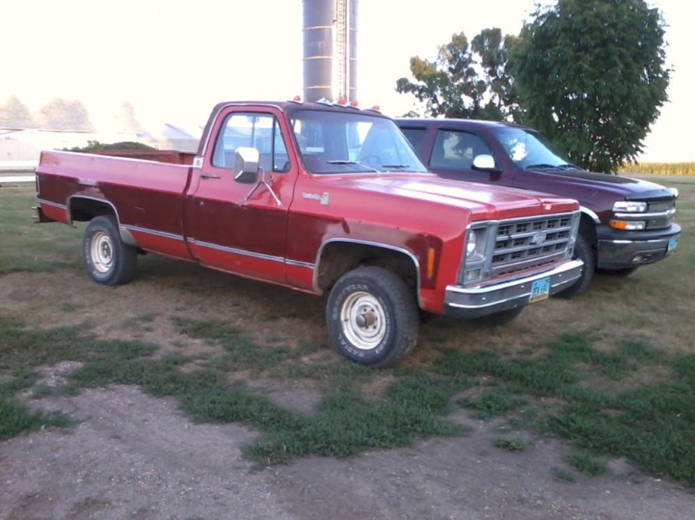

So just cus im excitied im all done with the dirty work and just down to fixing the back fire here is were im sitting, All buffed out, removed propaine junk under the hood and ugly tank, new air cleaner, fuel filter, rotor, cap, plugs, wires, fuel pump. Replaced all vacum and emmision hoses and rerouted them to look better along with new heater hoses then new master cylinder, new front bleeders, cleaned front rotors and brake pads, cleaned and pack front hubs, replaced all rear brake lines, rear brakes, springs, pistons, and drums. Flushed engine oil and filter, front diff, rear diff, transfer case, and flushed tranny and filter. Replaced rear right leaf spring pack, installed new carpet and shampooed seat and polished dash and black bezzels. And im sure im forgeting other odds and ends but thats the bulk of it since i became a member here and with alot of your guys's help so i wanna thank you guys so far.
