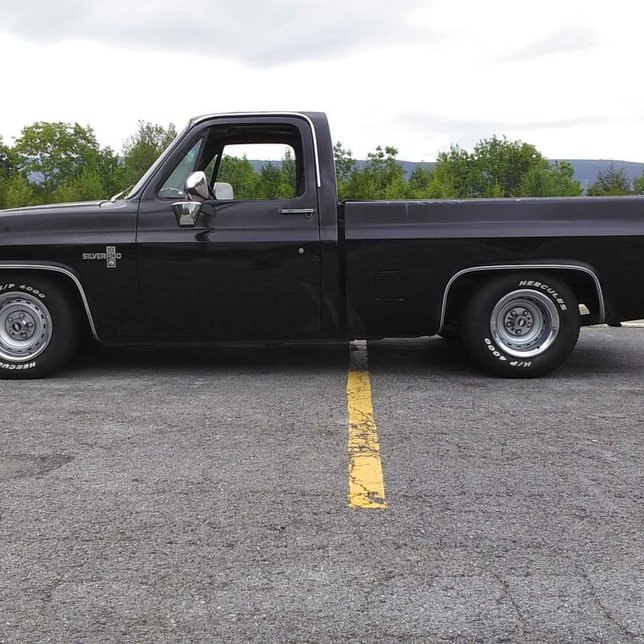

I am running a 275/60-15 which is 10.8" wide. A lot of people run a 295/50-15 which is 11.6" wide tire. In the front I run a 6.5"x 15" wide rally wheel with a 225/70-15. Even with a 6.5" wide wheel in front, the wheel well rub the LCA when turned lock to lock. You will need to use suck on wheel weights, not the ones that clip on the loo of the wheel. Front: 2.5" spindle & 1" drop spring. Rear: 5" flip kit
