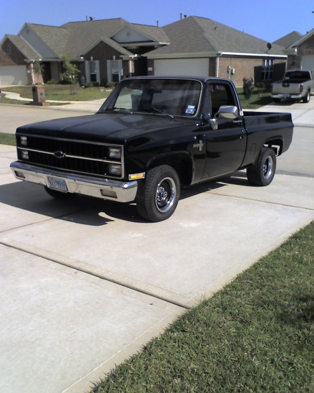

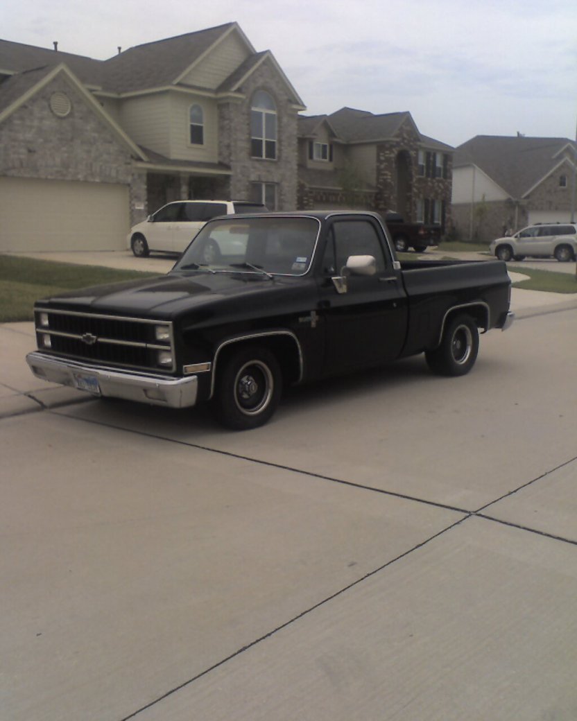

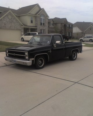

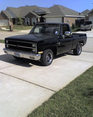

Here is a pic of before and after cutting front coils.
