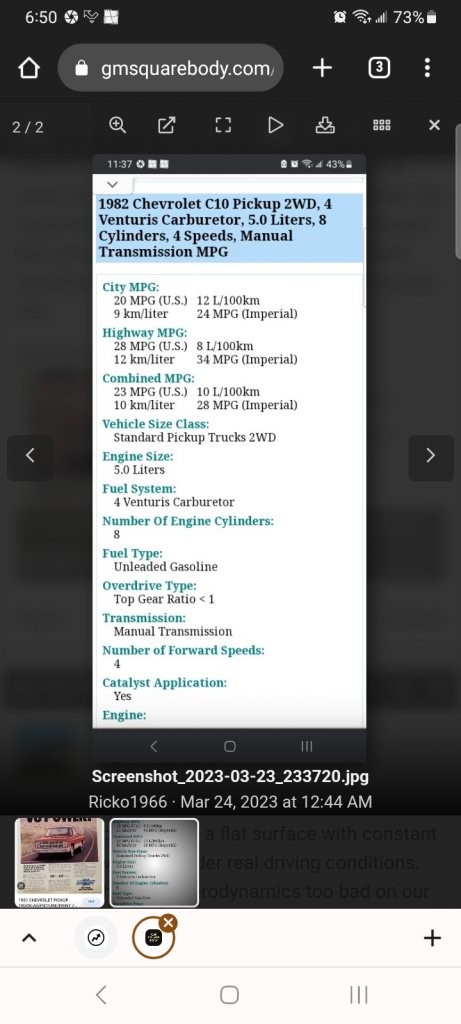

Ricko1966, That had to be a V8 diesel truck getting 28mpg highway, and with the "standard rear axle" 2.72 gears!!
Nope it's a 305 but I don't know what's different on the special economy edition. Regular 305? 305 with a different cam? Heads? IDK
