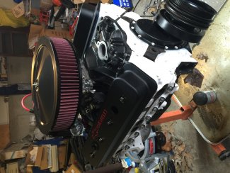

My motor is white with black/red accents see attached photo. Well my tube is having issues around the #6 cylinder. I was looking at some ones on Jegs/Summit but if I can get away with using the stock one I would like to go that route. My problem with bending the stock tube is pinching it **** rendering it usesless.

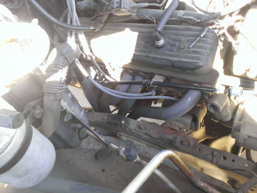

Here's a pic after the install. My motor isn't as pretty as yours.
EDIT: This pic was taken b4 I realized dipstick tube wasn't seated properly hence the stick protruding a bit. That sucker is easy to remove, but a PITA to reinstall!

what type of headers are those? The hookers have a closer tube between 8 and 6. Thank you I haven't seen many white motors out there so figured it would look good.

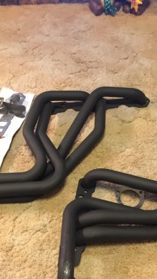

Ah then they should be similar. See how the #6 tube is routed and the #8 goes straight down? The tube is hitting on the #6 and it doesn't line up quite right. Also I'm worried about the tube being so close the headers with all the heat.
I see your problem. The way #6 & #8 are routed is different than on my tubes. I don't know how you would go about fixing that. Hooker kinda got screwy with the routing. Don't know why they routed #6 on top of #8. Weird.

Yeah lol I think an aftermarket dipsticks is my answer.
