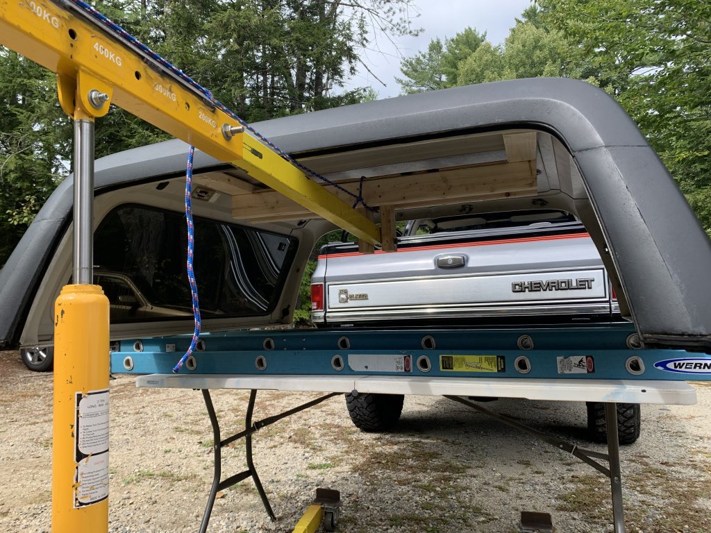

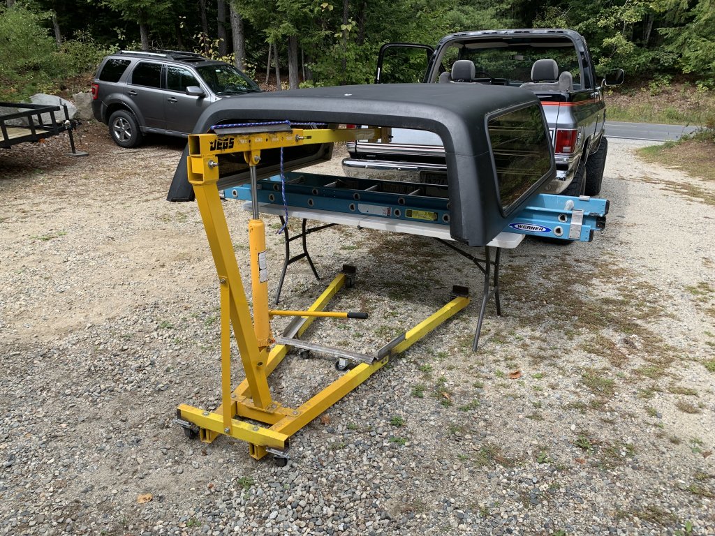

87 K5 Blazer. I know there are posts on this but mine here is specific to removing the top using an engine lift. Anyone done this, also approximately how much does the top weigh? Trying to accomplish this with one person behind the lift and one person holding a corner of the top to stabilize. Would be lifting the top by driving the arm of the lift inside from the back window and balancing the top on that. After driving the truck out the lift would have to be lowered setting the top down on the front corners first, so this working is definitely contingent on what the top weighs. Any thoughts?

I think ill give it a try and at least lift it an inch or so off the truck and see how it feels

Just have the wife and I. I am hoping the engine hoist can take the brunt of the load and she can just balance it to the ground. Was thinking of rigging some type of cross member for the hoist arm

Why not a simple block and tackle for deer and a couple of ropes to make a sling,hang it off the garage ceiling .
I think the arm for the cherry picker is going to get in the way. Unless you built a platform for the top of the arm, go in through the back window center the platform under the top, lift the arm which lifts the platform, and the top,drive out from under it.

Why not a simple block and tackle for deer and a couple of ropes to make a sling hang it off the garage ceiling . I think the arm for the cherry picker is going to get in the way. Unless you built a platform for the top of the arm, go in throught the back window center the plat form lift the arm which lifts the platform and the top,drive out from under it.
Good idea. Id like to leave the garage out of this. The hoist is already taking up real estate so it would be nice if it worked. I will keep the block and tackle in mind though.

Ricko that is exactly what I did, and wanted to do. It was super easy and all I had the wife do was keep a hand on the corner to help balance it.

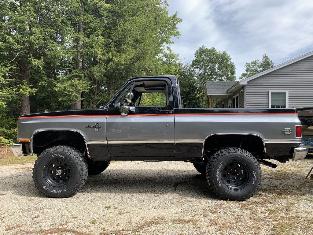

Here are some pics. It did not feel like a heavy lift

Gonna get a Softopper for it?
Not a huge fan unfortunately. And I dont run a back seat. Might be cool to get a snap canvas that runs from the cab down to the tailgate
