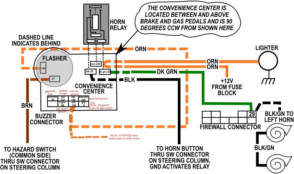

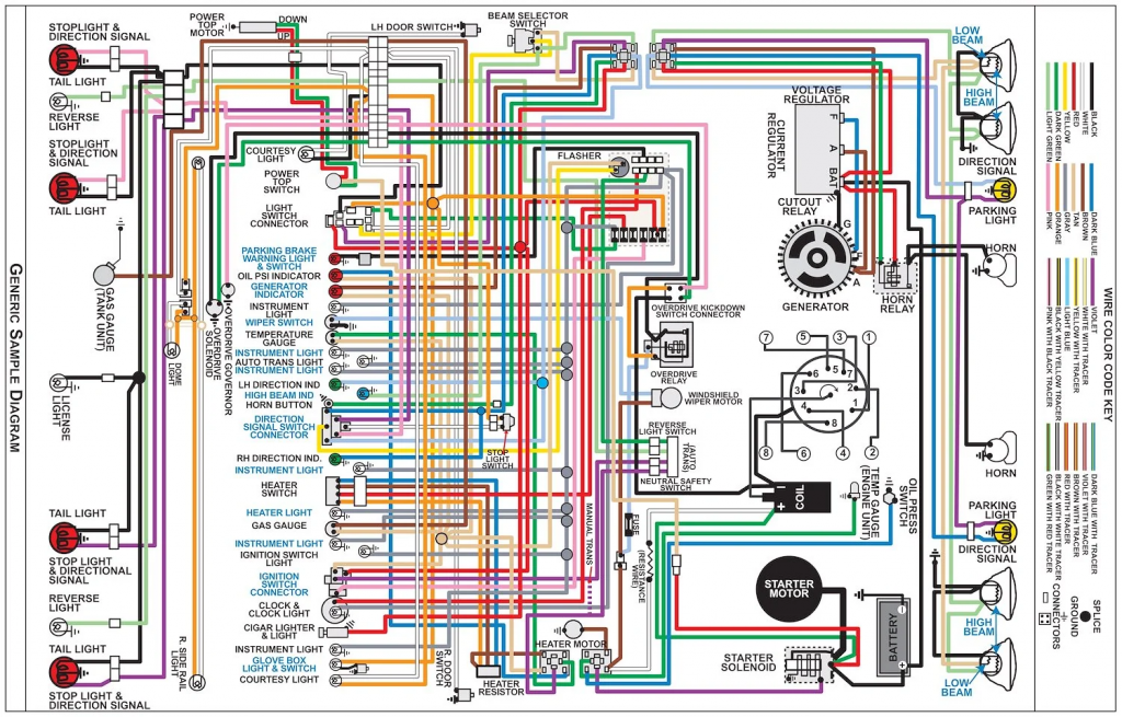

My first thought is, WTF??
Second thought is, start with the basics. If someone crossed the HVAC over with the convenience center, your problem is under the dash not under the hood. I don’t know what year make or model you are working on, but maybe these will help.

On the dome light circuit, orange is hot all the time. White is ground and effectively the switch for those lights. If white was hot it would be liveshorted across one of the lights I think.

Maybe start with the door switches. Pull them out, they should have an orange wire attached. They are ground activated. If they are broke, rusted or permanently grounded in the panel, that would do it

Door switch wiring is white, and the switches ground the wiring when the door is open. Orange wires are the constant power feed to the interior lights, cigarette lighter, etc.
Horn wiring runs to a horn relay under the dash. IIRC, it is not plugged into the fuse panel, but is a separate relay.
Wiring for the blower high speed (not the lower speeds) runs through a blower relay mounted under the hood on the A/C plenum. The relay activates high speed through the dash switch, and/or also switches to high speed if the A/C control is on MAX/recirculate.
Power for blower high speed is through a separate fused line that runs across the top of the firewall, from the power junction near the brake booster over to the A/C plenum.
