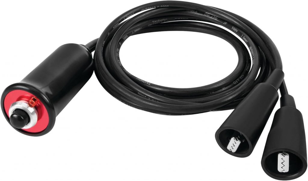

If you just need a quick workaround, you can buy one of these or make one. Its just a way to manually activate the starter. On the solenoid - clip one onto the S and one on the B. Press the button and the starter kicks on.

Like your idea about the remote started switch...Also want to fix this darn sign sw. problem. Any more ideas? Thanks DR.

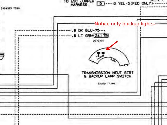

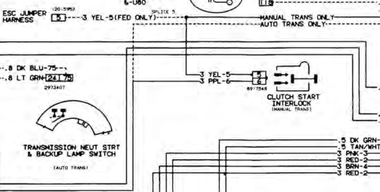

1985- automatics do not have a neutral safety switch. Went to mechanical interlock on steering column/steering wheel

I doubt he has a neutral safety switch,didn't read his year and don't remember the break off the top of my head. If the new switch helped for a while,I'd verify that the ignition switch is traveling through it's full range of motion, pull it down use a screwdriver to push the switch see if it works then. Am suspicious of the ignition rack.
