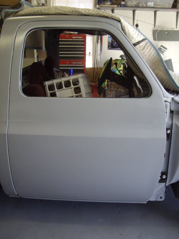

Nicely done Robert, what did you use to fill the holes?
robert8096
Mar 27, 2011
878
58
Goose Creek SC
Robert
Just regular 22 gauge sheet metal from the hardware store.
