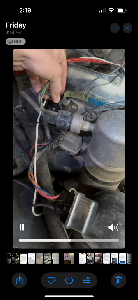

Hi everyone I have an issue with my heater and have not been able to figure it out. My blower wasn’t getting power so I swapped the relay, resistor, and switch. I also ran power straight to the blower and it works.
I tested voltage and am not getting power to the purple wire at the relay or any wires in the switch.
I tore all the lumes off and traced the wire from the fuse box and found that the wire is cut however I cannot find another wire for it to connect to. The wires from the relay/resistor to the switch are all in tact. I looked at the wiring diagram that shows it should be tying into a yellow wire but there is also no yellow wire at the resistor or under the dash I could tie it to.

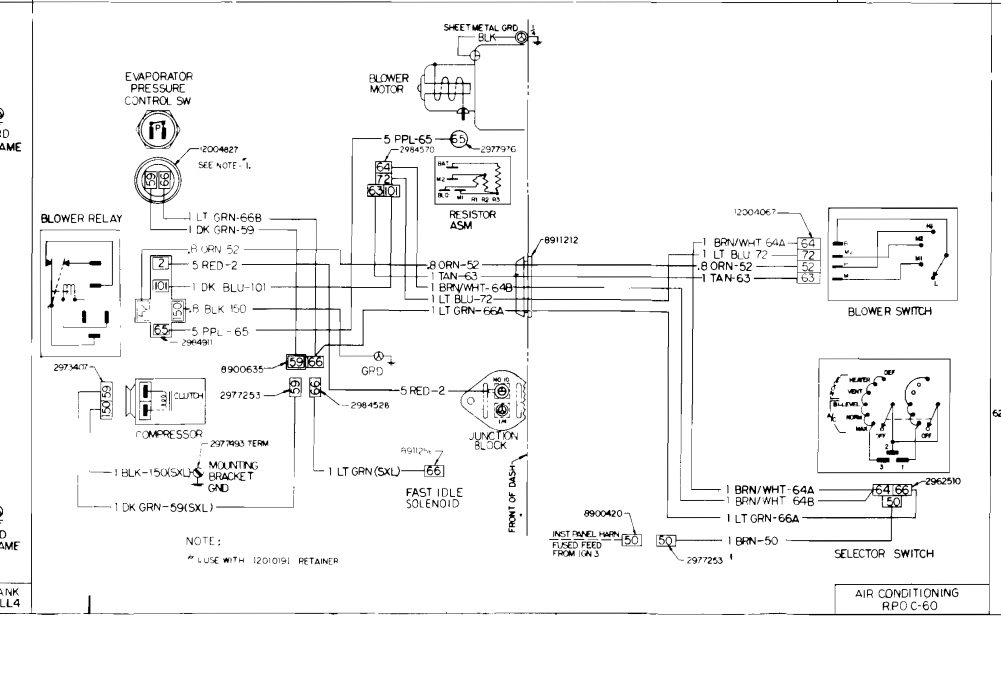

see attachment- your setup looks like this- correct?

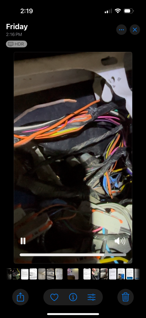

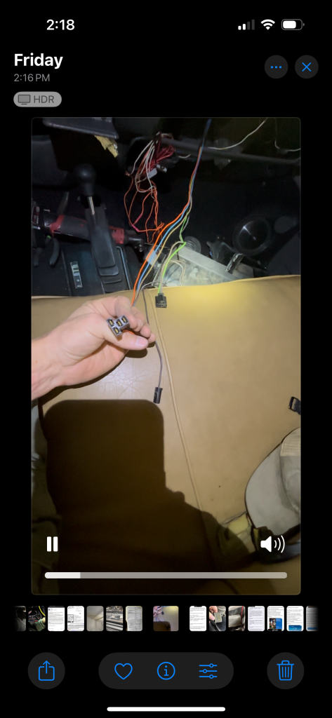

The cut wire is a brown wire that goes straight from the fuse box in the cab under the E brake pedal to behind my cluster and then is cut.
I’ve followed the wires from the relay/resistor to the switch and there’s no cuts or breaks.

To confirm- your truck has AC? are you using the diagram that I attached in my previous post or are you using one that looks different? I'm still trying to figure your setup

The diagram I was using looked different from the one you sent me. i found out that if I splice that brown wire from under the dash to the brown and black wire in the switch everything works accept the high speed. It’ll blow the fuse instantly if I do that.

Use my diagram and see if it makes more sense. BRN-50 coming from fuse box should go to selector switch. (It might also split off and go to generator/alternator light in instrument cluster if you don't have gauges) The selector switch is where you turn it on and choose A/C, heater, vent etc.. a BRN/WHT wire should go from selector switch to Blower speed switch.

Thanks! It worked I was able to get it to turn on and switch through the speeds. It blows my 25 amp fuse every time I turn it on high but at least I have heat now
