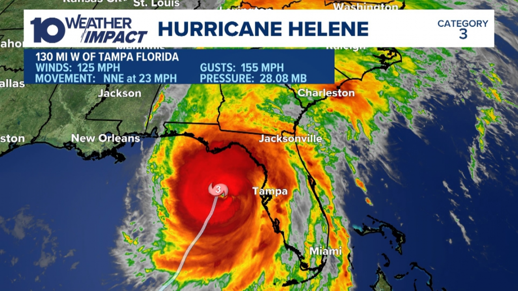

Photos after the Hurricane goes on by ...
This one is ripping stuff up .. Will make landfall in the Panhandle latter tonight ..
Mother Nature is really pissed !!

Powers out, over a million people are without power here in the Sunshine state ..
I'm running on batteries at the moment, solar panels got a full charge on them before the storm hit .. Will have power for 4 or 5 days with no sun on the panels ..
Trees are down all over the place ..
Storm surge was reported to be as high as 20 feet in some places along the west coast ..
The Howard-Frankland bridge connects Tampa to Clearwater ....
Helena was a rough one !!
Helene is expected to remain a full-fledged hurricane as it rolls through the Macon, Georgia, area on Friday, forecasters said.
It could bring 12 inches (30.5 cm) of rain or more, potentially devastating the state’s cotton and pecan crops, which are in the middle of harvesting season.
