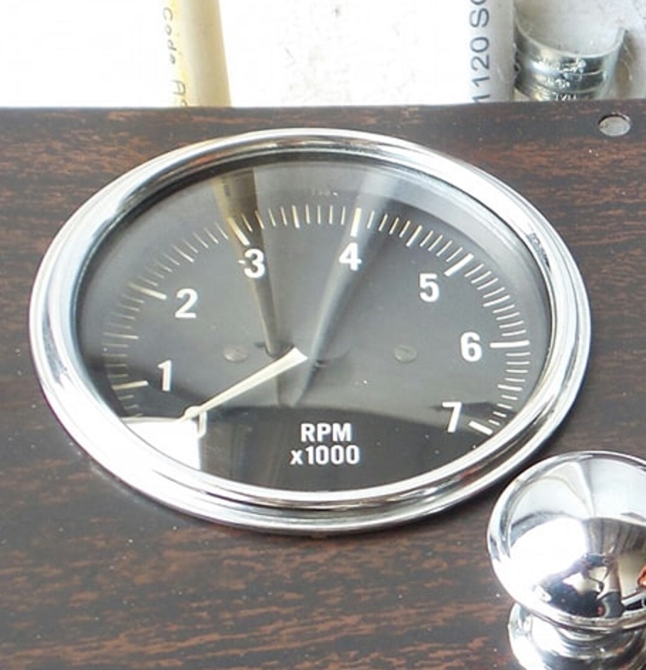

Well, I decided not to use the bezel for the vacuum gauge ..
It being in bad shape where it mounts to the gauge cup was going to be a eyesore ...
Will be on the hunt for another VDO tach just like the one I have ..
Do think I can make the bezel work much better than the one I have in hand ..
The finish look will be the same as how the tach looks in the dash ..
