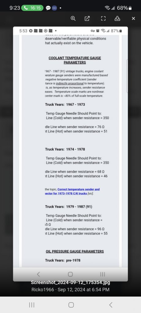

10,167
19,654
Well lucky for me it looks like my 1993 senders are the same as most 73-87 trucks.
SA
I didn't think the spread was that big I thought it was 3 different groupings. I'm actually 90% sure it is. Oil pressure senders changed at least once also
